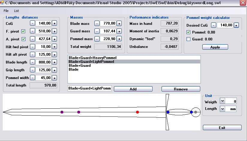

Hail everyone!
I'm working on my first sword for some time, it's in the final stages, but now I'm facing some decisions that are hard to take, so I'm asking for your advice.
To give you an idea about how my sword will look like, the closest relative is the Albion Templar.
Here are some characteristics:
Blade length: 80 cm
Total length: 95-98 cm (not decided yet)
Blade width: 44 mm at base tapering to 30 mm
Blade thickness: 7 mm at guard tapering to 3.5 mm (5 cms from tip)
Blade mass: 770 g
Crossguard mass: cca. 100 g
Pommel mass: 240-330 g (not decided yet)
Pommel diameter: 45-50 mm (not decided yet)
CoG without guard and pommel: 24.5 cms from guard
CoG with guard, without pommel: 21.5 cms from guard
Now I have some dilemmas:
Short (105 mm) or long grip (125 mm)?
Light (240 g) or heavy (330 g) pommel?
Note that I'm 6' 0'' tall and I have a rather large hand, so normal 9-10 cm grips feel quite uncomfortable. A 10,5 cm grip feels fine with hammer grip, but no so great for handshake grip or when aiding with the left hand.
A light pommel looks better and and will lead to a lighter sword of cca. 1100 grams but with a farther CoG (cca 14 cms from guard) with some little variations depending on grip length. A large pommel besides unbalancing the sword will add weight but leads to a better CoG (11,5 - 12 cms from guard).
Following Vincent's instructions I wrote a little program to calculate some basic characteristics and determining pommel weight - CoG variations. I attached some screenshots with different setups.
http://www.postimage.org/image.php?v=Ts5bfxS
Note that the pivots are not yet measured so any characteristics related to them should be ignored.
I will appreciate any advice or opinion so please help!
Arpad

1) First make grip and pommel of some modeling material (clay-like stuff). Check if it feels OK. If it does not make the grip shorter/longer as required and check again. Repeat as many times as needed. And if you plan to use the sword with a gauntlet on make the grip at least 1.5 cm longer than you would make for bare hand. Personally I prefer longer grips. After all, you can handle a long sword with 30 cm grip with one hand without any problem.
2) Make the grip, put the crossguard and the grip on the tang. Attach weigh to the end of the tang equal to the desired weight of the pommel. Check if the sword feels OK. Reduce or increase the weight if needed until you get what you want. This way you shall know the required weight of the pommel.
Finally, length of the grip and balance of the sword are purely personal preferences and depend on what you expect from your blade. Your sword will be a better cutter with a lighter pommel, but will be fester with the heavier one.

Thanks Aleksei, your methods are simple yet very practical indeed.
I attached a cca. 200 g piece with tape and the sword felt lazy and blade-heavy. With 400 g pommel the sword was quick and responsive, but a bit bulky and offset. The correct weight is between these two values.
Now I have to figure out an adjustable pommel, adding weights and swinging the sword is quite challenging. I will try to secure a 200 g weight on the tang fitted with strong neodymium magnets (those found in hard drives - older models have bigger and stronger magnets) then by adding weights (sticking coins or something) I can fine tune the pommel until the sword feels just right.
I still don't understand why period swords had such short grips. I will stick to the long grip, I can shorten it any time after all. It feels much comfortable and offers a greater freedom for different techniques.
Luka, those swords might have a better mass distribution. Unfortunately I couldn't find a wider piece of material to make a better profile tapper.

the handling is favored the first solution has a better inertia. Why aren' t there other points of inertia? X Y Z? You can post the formula you calculated the pivot.
Ciao
Maurizio

I don't have a formula to estimate the first pivot points pair, only the "wiggling method". I wrote the software based on Vincent's formula to get the other pivot points knowing the first and vice-versa. Unfortunately I used my old studenthood method (understand-learn-take the test-drink-forget). It was something related to geometric representation of moment of inertia and constant area rectangles. Oh, yeah now I remember:
d(R1,G) * d(P1, G) = d(R2,G) * d(P2, G) where
R1 - first rotation point on hilt
P1 - pivot point on the blade for R1
R2 - second rotation point on hilt
P2 - pivot point on the blade for R2
G - balance point
Those pivot points in the pictures I postedare not correct, I have not yet done the wiggling test.
What you mean by the X,Y and Z. Moment of inertia for all 3D axis?

The formula is correct Arpad, glad to see you remember it Happy
I'd go with the second solution personally (that is, light pommel and short handle), but perhaps that's more because of my own tastes...
