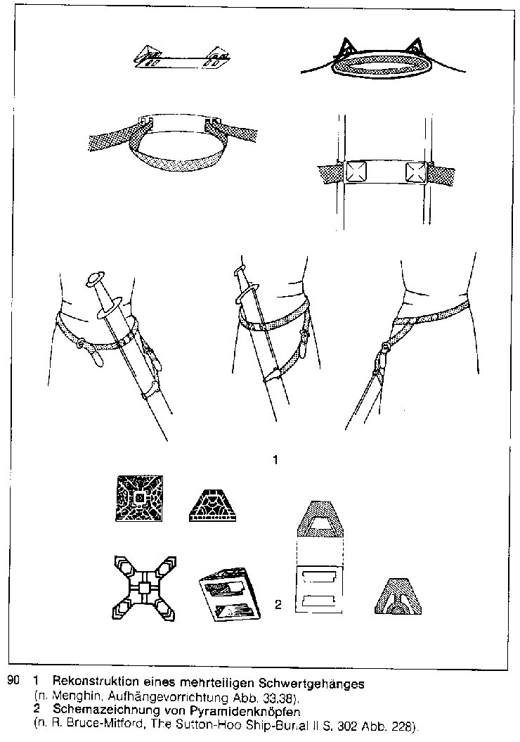

Here are some examples I've bookmarked. Some, if not all, may be from Peter Johnsson but I don't really have the time to research their origins at the moment. Please forgive me Peter!!!!
 Attachment: 49.55 KB
 Attachment: 59.16 KB
 Attachment: 103.17 KB
 Attachment: 112.74 KB
