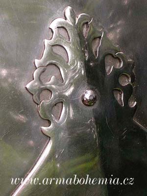

PostPosted: Fri 29 Dec, 2006 10:47 am    Post subject:         Quote
Might be nice with an illustration, its not that often you see pics of the parts separated. In swedish armour-termonology a 15th cen two-peice breast plate is actually called "crayfish" or "Kräfta".
You can see how far they overlap messuring from the rivet-hole.
Beautiful breastplate, by the worlds friendliest armourer Stanislav Prosek..;/

Richard Fay
Location: Upstate New York
Joined: 29 Sep 2006
Reading list: 256 books
Posts: 782
PostPosted: Fri 29 Dec, 2006 2:28 pm    Post subject:         Quote
Hello all!
Yes, the illustration was very helpful. Thanks!
By the way, could you post one of the breastplate and plackart together, for comparison? If you could, it would be greatly appreciated.
Thanks again!
Nice piece!

Richard Fay
Joined: 29 Sep 2006
Posts: 782
PostPosted: Fri 29 Dec, 2006 3:15 pm    Post subject:         Quote
Hello again!
Nathan,
Thanks for the photo! Great stuff!
Having both posted really helps me to visualize the overlap. It seems it overlap more in the chest area than the abdomen, but it still gives doubled protection over at least a part of the torso.
Thanks again!
