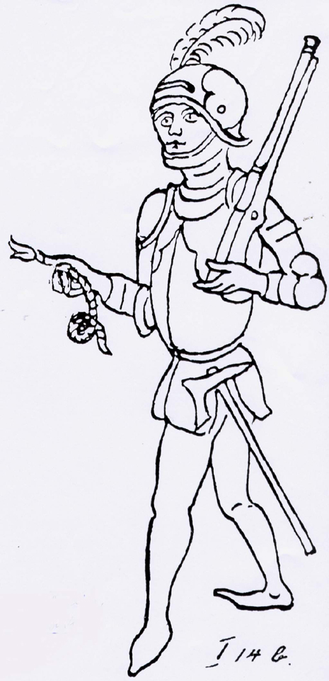

The serpentine itself held a smoldering piece of fungus while the gunners carried a length of very thick slow match around their arm or perhaps wound round their gun.
The thick slow match in contemporary depictions.
A gunner at Pavia with a very substantial smoldering slow match wound round his arm while the serpentine held a much smaller tinder
This makes me wonder exactly what kind of smoldering tinder is shown by Hartleib and other early 15th century depictions, is it a really short and presumably thin slow match or perhaps some fungus like in later lock mechanisms.
It might well be that slow match was something invented in the 14th century while guns with a lock mechanism that were fired using a cord of slow match, as opposed to fungus, were a 16th century thing.
