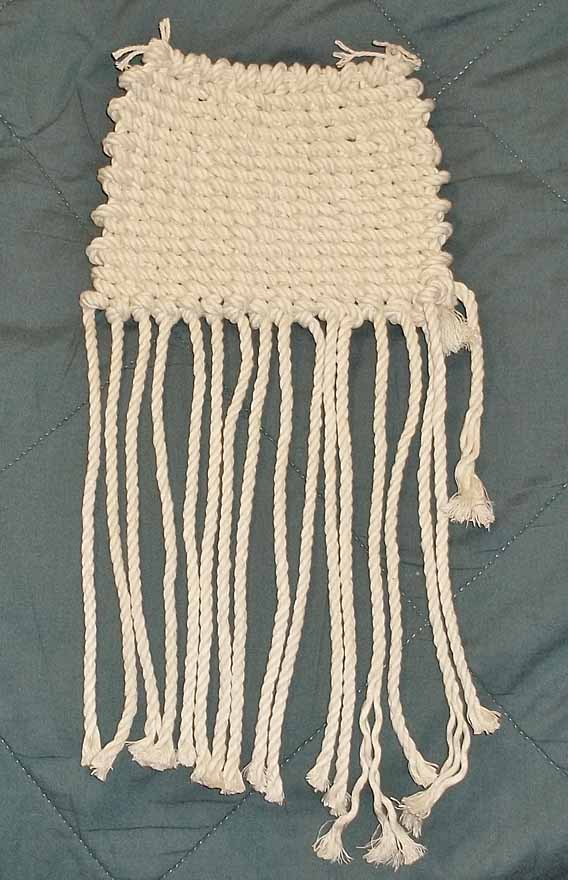

There's an excellent description of a linen cuirass donated to a Greek temple by an Egyptian pharaoh, Amasis. It says each cord was spun of 365 individual threads. This is clearly not regular linen fabric, but must be *twined*, a method still used for rugs and handbags. Here's a sample I did:
The mentions of "2-ply" or "3-ply" have to refer to twined linen, as well, since 2 or 3 layers of garment-weight linen (or even canvas!) isn't going to do much for you!

Fringes and tassles are an artefact of early weaving techniques. They aren't an indicator of twining. There are at least a dozen interpretations of the armour in the above "Warrior Vase" and all of them are valid based on the available evidence. IIRC Matt has already reconstructed two different interpretations - both are pretty cool.
We know that there were at least three ways to make linen armour.
1. Many layers (10-30) of cloth stacked and quilted
2. Stuffing a shell like a cushion and compressing it with quilting.
3. A few layers (2-3) of twined linen
We also have examples where 1 and 2 were used in the same construction.
