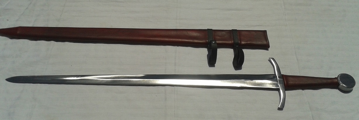

NOTE: To see the thread showing the process in which this sword was made, it can be viewed here. Also, the best place to get pictures of the sword would be from the aforementioned thread, because his pictures are clearer and cleaner than anything I could muster with an amazingly terrible old cell-phone camera. In fact the uploaded image of the finished product is one of his images that was cropped down and resized enough that I could upload it.

Sword Specs
The sword is built using an Albion Swords "Bare Blades", heat-treated "Riding Sword Blade". Stock, the blade is 26" with an overall length of 32.75". Personally, I think the blade most closely resembles an Oakeshott type XVIII. In the end, the blade length was maintained, but the overall length increased a fair bit (more on that later). The final stats are as such:
Overall length: 33.5 inches sword length, 35.5 inches in scabbard
Blade length: 26 inches
Blade width at guard: 1.625(5/8) inches
Guard width: 5.9375(15/16) inches
Guard type: Oakeshott type 6
Grip length: 5.125(1/8) inches
Pommel type: Oakeshott type H
PoB: 3.5 inches from guard
CoP: 17 inches from guard
Weight: 1.9 pounds
Edge: Well sharpened, fully capable of heavy cutting use
Finish: High-shine polish, non-mirrored

One of the things I wanted was a bit longer grip for two main reasons: 1. I did want the point of balance closer to the guard for handling the lighter and shorter than average blade -besides the fact that riding swords are meant to be versatile- and 2. I wanted it to feel comfortable with plenty of space to grip, even with full plate gauntlets. Thusly, Alan had recommended using a recessed nut for attaching the pommel and eking out the desired extra length. This was something I honestly hadn't heard about before. All I really knew of was peened tangs or threaded pommels. As Alan even described it to me (attachment 1: his drawing with the description), the tang is threaded, but the pommel is not. Instead, the nut is recessed into the pommel and extends the tang's length by a bit without any sort of weld. Not only does it feel extremely (and honestly surprisingly) solid in the build, just as solid as a peened tang, but it makes it nice and convenient any time I would wish to dismantle the sword for thorough cleaning/polishing/oiling.
The grip and scabbard are both made with a wood core and leather wrapped. The grip also has a nice wire-wrapped texturing that, while a subtle and pleasant aesthetic, provides a nice feel and extra comfort when not wearing gauntlets or gloves. While the scabbard may not have a locket or chape (planned to-be-added later when Alan gets his lockets and chapes where he likes them), the blade still sits quite firmly and snugly into the scabbard. The only time the blade comes loose from the scabbard (with no effort) is when flipped about five-to-ten degrees from perpendicular with the ground. Considering I don't plan on doing any summersaults or back-flips with the sword any time soon, I'd say that's a pretty solid and snug fit. The leather at the tip of the scabbard is tightly crimped and has little-to-no chance of being pulled loose or getting worn ragged (again, once Alan has his lockets and chapes where he likes them, I plan on having them added to the sword).
The main leatherwork for both the grip and scabbard have a consistent and even dark red dye replicated and hand-mixed from a color pallete of "Antique Oxblood" that I found for antique furniture leather restorations. I'm impressed Alan was able to nail the color so well. Now, while there is no stitching anywhere on the scabbard or grip, the glue is unrelenting and the seams are tightly pulled together . . . so I don't see it being a problem unless I somehow were to put the sword somewhere it's going to be way over 200 degrees Fahrenheit and possibly put the glue itself in jeopardy.
The built-in hangers for the scabbard are also respectable and well-fitted to it with peened rivets. Subtle grooves on the scabbard body (that appear/feel to be built-up/walled with some wire/cord wrapping around the wood and under the leather) ensure that the hangers don't shift freely. When hung from a belt it sits at a nice 45 degree angle. This provides for smooth drawing/sheathing, as well as removes any worry of banging the sword/scabbard against the ground (I'm only 5'3", so it is a concern for me, and another reason I didn't want a longer blade).
As far as the metal on the sword goes, everything is top notch. According to the Albion Customer Service Representative, when properly finished, the heat-treated blade blank should be comparable to anything from their "Next Generation" line of swords. I would certainly say that Alan accomplished this. On top of that, all of the other metal hardware on the sword is solid, well polished, mild steel of a respectably high quality. I fully expect this sword to last a lifetime, as long as I take good care of it and don't encounter any accidents or intentionally destructive/abusive use.

This weapon, built around the Albion Swords blade blank and finished with custom hardware/fittings by Alan Schiff of Paladin Forge, is a wonderful piece that I will treasure dearly. It's a pleasure to wield in it's highly versatile and functional build, while at the same time being aesthetically pleasing with it's practical and simple construction. Again, Paladin Forge (website located here) was an absolute pleasure to work with and I look forward to doing business with Alan in the future. I would highly recommend him to anyone looking to get some respectable and high-quality custom work done, at a reasonable price.

Completed Sword - Note: scabbard got cut off a bit shrinking the image enough to upload, the full image (and better quality) is available in the build thread. [ Download ]

Thanks for the review, Ben! I'm glad you like the sword so much. I wish my pictures were better, though. It gets so sunny here sometimes that the glare messes with my camera.
