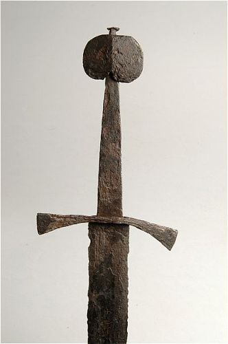

I have found a Norwegian sword looking very much like the Boringholm sword. [Very much like it !] Likely the one Bruhn-Hoffmeyer had looked at.
It has image and info on the "Kulturhistorisk museum, Oslo" webpage, where one can press to see a somewhat bigger image.
http://www.unimus.no/arkeologi/#/detailsView?search=C851
It was found at the farm "Skybjerg" in Oppland according to the overview-info, but in the info page (see below) it says the farm Rognstad).
Info:
Inventory number: 851. [should be C851 now]
"Et Sværd af Jern; den hele Længde 1 Al. 201/2 T.; Hæftet for sig: 91/2 T., og det egentlige Haandfang 7 Tr.; Knappen rund og fra Siderne fladtrykt; Pærerpladen næsten 6 Tr. lang, flad, bredere i begge Ender end paa Midten; Klingen tveegget, med en Fordybning langs Midten indtil omtrent halvveis for oven; noget tilspidset mod Enden. Sværdet kan ifølge sin Størrelse og Form antages at have været brugt til at hugge med begge Hænder. Det er meget vel konserveret paa det nær, at Bedækningen er borte af Haandfanget. Det er rimeligvis fra Slutningen af Hedenskabet eller og fra Kristendommens første Tider. Fundet i Jorden paa Gaarden Rognstad i Øjer omtrent 1/4 Mil fra Præstegaarden paa hin Side Elven."
Source: http://www.unimus.no/arkeologi/resources/musi...umsnr=C851
The length of the sword is given as 1 Alen and 20,5 Tommer.
1 Danish/Norwegian "Alen" (English "Ell") was 62,74 cm in 1875 and adjusted to 60,96 cm in 1959.
1 Danish/Norwegian "Tomme" (litt. Thumb, English "Inch") was 2,614 cm originally 1875 and adjusted to 2,540 cm from 1959.
The text given above is basically written Danish with use of double aa, so the earliest measurements from 1875 are probably the correct ones.
So 1 Alen 20,5 Tomme for "hele længden" (the entire length) gives 116,3 cm.
Hilt (hæftet) 9,5 Tommer -> 24,83 cm, whereas the Grip (haandfang) is 7,5 Tommer -> 19,6 cm. [This seems more likely].
That would give us a blade length of ~91,47 cm [ very close - identical? - with the blade length of the Boringholm sword that is 91 cm].
Crossguard (parerpladen) almost 6 Tommer -> so around 15 cm [reckon 7,5 cm on each side of the blade].
Same type - but less preserved - from the farm Dvergsten in Oppland [C1530] is very slightly shorter; but it could be caused by the tip is broken off.
Source: http://www.unimus.no/arkeologi/#/detailsView?search=C1530
A third fragmented one [C805] but with all the hilt and crossguard preserved - from the farm Brevik Søndre in Akershus - shows that this sword was popular in Norway.
Source: http://www.unimus.no/arkeologi/#/detailsView?search=C805

I'm just chiming in to remark that the recent dendrochronological and historical dating of the Boringholm voldsted renders Oakeshott's dating of the sword obsolete because it is based on an earlier dating of the voldsted, as stated in the book referred to by mr. Rasmussen.
Alternative and higher resolution images of the Norwegian variants referred to by Rasmussen can be found here (Click on image to get high resolution):
C851
Drawing showing a maker's mark(?)
Whole sword
Closeup of hilt
Hilt other side
Hilt side view

Thanks Hr. Kongsrud for the extra picture of the Norwegian swords and the reference to the obsoleteness of the Oakeshott dating of the Boringholm sword.
The Boringholm sword seems quite unlikely to be from 1300-1320, when the Boringholm complex is dated from 1368-1412.
Likely the 3 Norwegians swords are from the same time period, since the C851 Norwegian sword and the Boringholm sword are so much alike that they could very well be from the same weapon-smith?!

Mind you, the shape of the pommel on both C851 and C805 differs from the Boringholm sword. Both seem to me to be of a subtype not discussed by Oakeshott with the sides of the disk tapering to both sides from a vertical ridge..
You are correct there! The two Norwegian swords with pommels preserved are clearly of a different type, than the two Danish ones (and the English one, though this one has a different guard)! So we have to reckon with a special Norwegian sub-type.

Marko Aleksic classifies these as an additional subtype H2 in Swords from Southeastern Europe... this is an excellent source, make sure to download the full book from Academia.edu if you do not have it already!
He identifies three swords with this pommel type, two found in close proximity in Serbia, and one more from Bosnia. The Serbian blades are both XVIa's with similar hilts and overall dimensions... Aleksic suggests they are locally produced; one comes from a hoard of weapons found in a village named Kovačnica, which translates to "blacksmith".
Here are some photos that I have collected of this sword, which is held in the Jagodina Regional Museum:
I know of one additional Northern example, this from Sweden:
[ Linked Image ] [ Linked Image ]
http://mis.historiska.se/mis/sok/fid.asp?fid=108245
Taken all together, it does seem to be a rare pommel type but not a regionally exclusive one...

Thanks Mark for the added finds of this sword type.
Your ability to find "companion"-examples from your vast picture-collection, no matter what type of sword I introduce, never ceases to amaze me.
So 2 Norwegian (third Norwegian lacks pommel), 1 Swedish, 1 Bosnian and 2 Serbian examples of this pommel type on type XVIa sword. That is some strange geographical variation (we are to far down in time to explain it away with any gothic connection here).
They look so identical that chance-likeness should not be the first assumption - yet they probably were all assembled locally (only blades imported). Interesting mystery!
