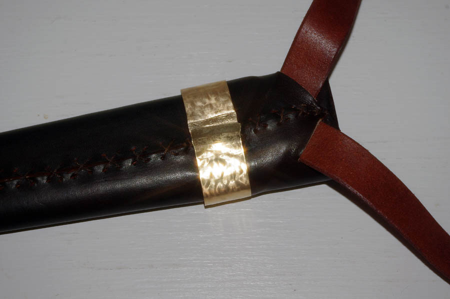

PostPosted: Fri 06 Jun, 2014 2:43 pm    Post subject:         Reply with quote
Well...... Here's what I did for my scabbard.
Poplar core
Leather sheath
Leather strap
Hammered bronze chape and band
Red wool threads

Here is a photo of the back on my scabbard. The baldric strap was glued across the front of the wood core, then the strap tails were crossed behind the scabbard and exit the leather cover at a 45 degree angle. No historical precedence, just a practical solution.
