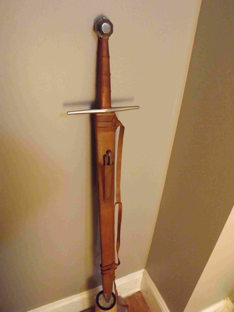

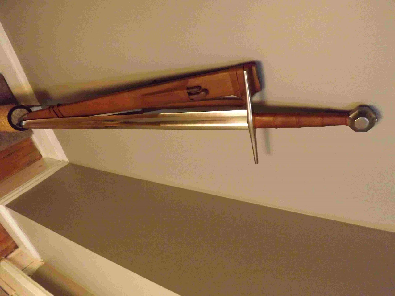

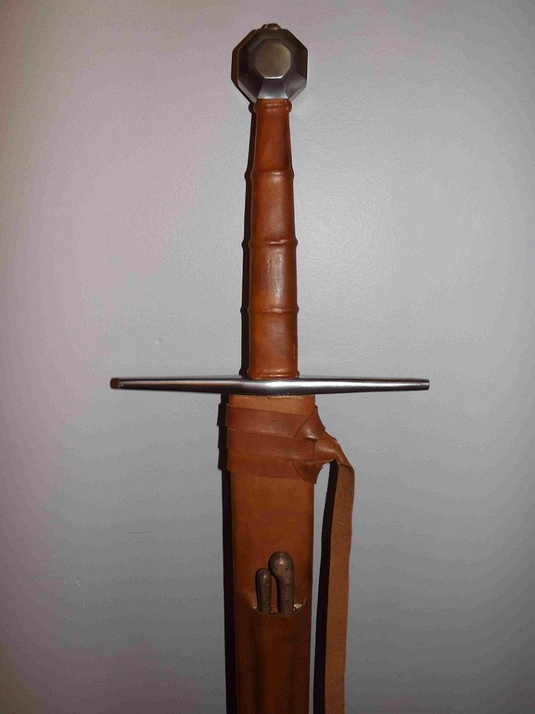

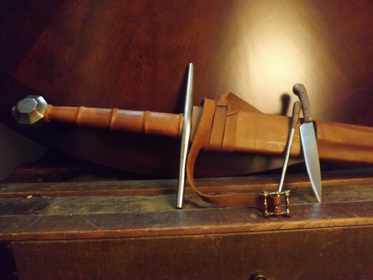

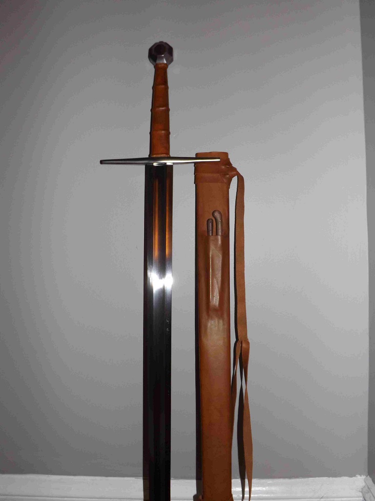

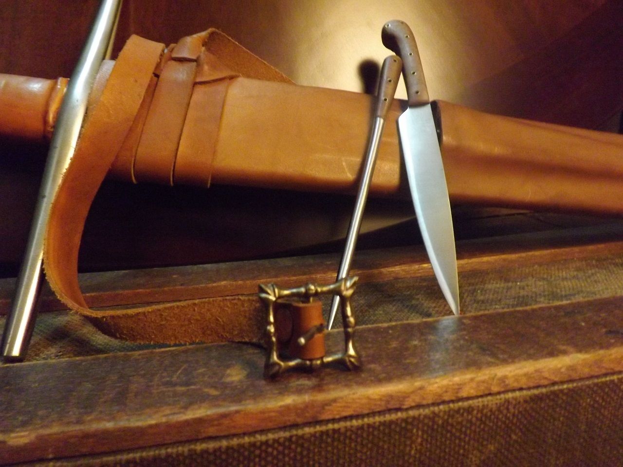

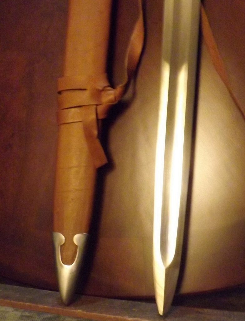

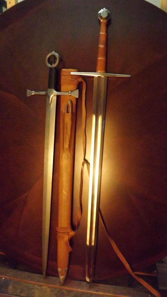

PostPosted: Tue 15 Apr, 2014 1:16 pm    Post subject: Pictures         Reply with quote
Here are a few quick photos of the finished piece that I received last July. Sorry for the late reply, things have been a little hectic here. I will upload more, as well as specs and a quick review in the next few days.

PostPosted: Tue 15 Apr, 2014 1:31 pm    Post subject:         Reply with quote
I like that sword very much. Thank you for having it made. Big Grin

PostPosted: Tue 15 Apr, 2014 2:06 pm    Post subject:         Reply with quote
I really like that. I have always liked the near parallel edges and long fuller of the type X. Looks really cool with the hand and half grip. congrats on your piece.

PostPosted: Wed 16 Apr, 2014 8:53 am    Post subject:         Reply with quote
Very cool sword. I have a couple custom 2-handers with the long fuller, wide blade and spatula tip.

PostPosted: Wed 16 Apr, 2014 9:56 am    Post subject:         Reply with quote
Yeah I like the looks of that, too.
Do you have any stats on it? I'd be interested to see how much a long fuller on such a big blade affects the POB for example.

PostPosted: Wed 16 Apr, 2014 10:23 am    Post subject:         Reply with quote
Interesting design, I like it very much. I also want to use this opportunity to praise the guys at A&A. Their standard sword models maybe are limited, some maybe could use some improvement, but their custom work is awesome. Copies of originals, more speculative pieces like this one, all awesome...

PostPosted: Wed 16 Apr, 2014 12:57 pm    Post subject:         Reply with quote
Congrats on the new piece lance, very nice.

PostPosted: Wed 16 Apr, 2014 5:53 pm    Post subject:         Reply with quote
On a purely historical note:
As noted above there are some early long-handled warswords with longer fullers, some quite narrow like an XI sometimes dated to 12th century and some 'in transition between Xa and XIII', in particular those from Central/Eastern Europe with late variant Brazil nut pommels dated to 13th century.
I don't recall seeing an original with a fuller this wide. I imagine its because the wide fuller is designed to lighten the blade for a quick slashing sword against lightly armoured or unarmoured opponents whereas warswords were designed to pack a big punch against somewhat better armoured opponents, so these components would be a bit at odds with each other from a functional standpoint in that historical context.
Of course, we are not in that historical context today so it doesn't matter if it makes you happy.

PostPosted: Thu 17 Apr, 2014 6:44 am    Post subject:         Reply with quote
If we want to nitpick, (sorry if this seems inflammatory; I was trying to find another way to put it), the scabbard is strongly 15th century in style, especially with the by-knife.
But, for what it is, I quite like this sword. It's a lot better and more interesting than most "fantasy" swords, and it has an elegance to it.

PostPosted: Thu 17 Apr, 2014 8:10 am    Post subject:         Reply with quote
Hi Guys,
Thanks for the praise and comments about the sword, I really love it. I must say that I left a lot of the dimensions and fine details up to Craig @ A+A because I trusted his judgment over mine, and am very pleased with the decisions he has made with this piece. I did comment on roughly how long it wanted it, and how far to extend the fuller, also that I wanted a very acute looking tip, but he deserves most of the praise. I will do my best tonight to answer any questions you might have about the Sword as well as stats for it, so if you have any questions about it, anything at all feel free to ask and i will do my best to answer. I am at work right now, and unfortunately have been told I am not allowed to wear it over my government uniform, Sad so I cannot post anything about it at the moment. I will say though if there is one word to describe it, it would have to be FAST, i have not handled that many swords of this size but when you close your eyes and hold it, it feels like a single hander to me.
Although it has some realistic elements I would have to say it’s purely a fantasy sword, ever since I was a little maniac (7) running through the woods with a blunted cutlass my uncle bought me, swinging it at trees and alders, I have had an image in my mind’s eye of what I thought a sword should look like, and I knew the one he had given me may have looked the part but was not the real deal. When I closed my eyes and thought of a knight holding his weapon on the field of war, or in a tournament, this is the blade I saw. I explained that to Craig during the process, and needless to say he has made a dream come true for this now adult tree fighting maniac.

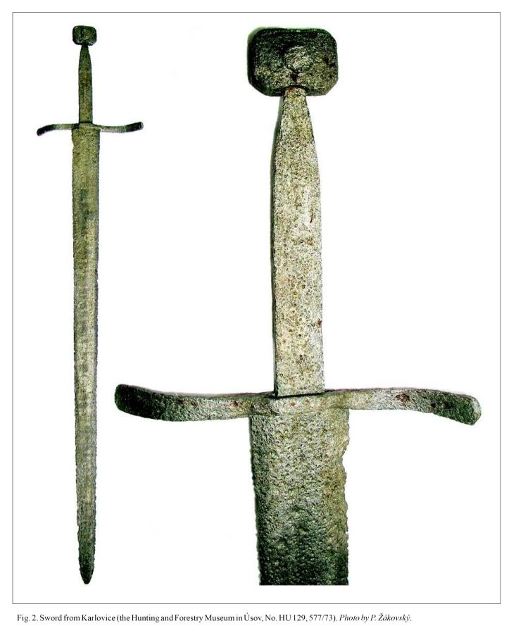

Hi everyone,

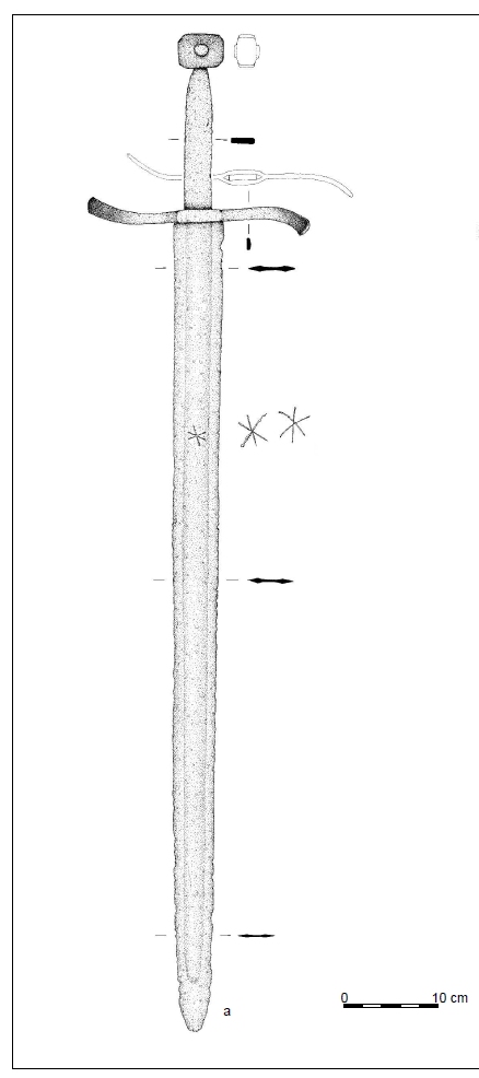

First time poster here myself... Coincidentally, I've just come across a recently published example of a (smallish) hand-and-a-halfer with a broad full length fuller. The sword is in a museum in the Czech Republic but is probably Hungarian in origin. It has been published in "Medieval and early modern weaponry from the collection of the Hunting and Forestry Museum in Úsov in Moravia" by Petr Zakovsky, available on academia.edu.
 Attachment: 185.32 KB
 Attachment: 72.12 KB

PostPosted: Sat 19 Apr, 2014 4:21 pm    Post subject:         Reply with quote
Mark Lewis wrote:
Hi everyone,
Interesting find.
It's cool the way swords of Eastern Europe seem to break all the rules that apply to Western European swords. This one seems to fall within a family of swords popular in 15th century Hungary. Some have wide half-length fullers but I haven't seen one like this with such a wide long fuller like a type X. Nevertheless, the smaller dimensions of this sword and likely its time period put it outside of the standard 'greatsword' or 'warsword' category.
