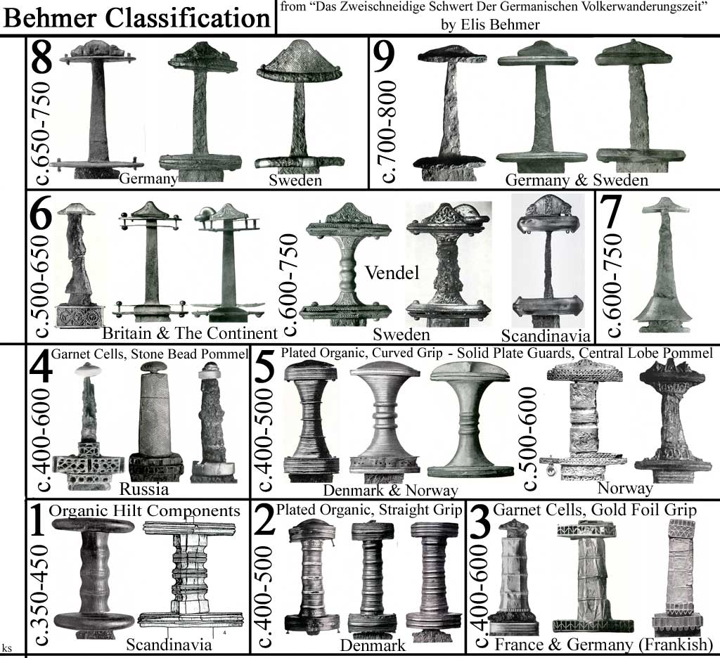

What type of hilt are you looking for, specifically?
 Attachment: 150.46 KB

i am currently constucting a behmer type 2 (feltwell type)
but my question was just if there is evidence for iron as a material in the sandwich construction of the guards.

Well, the Feltwell sword is quite early, so it's very likely that it's guards were completely organic. But I think it's a Behmer type 1 rather than a type 2 (see the chart I attached above).
A type 6 may well have iron fittings. But I have to double check to make sure. Types 8 & 9 are essentially early Viking-type swords, so...
