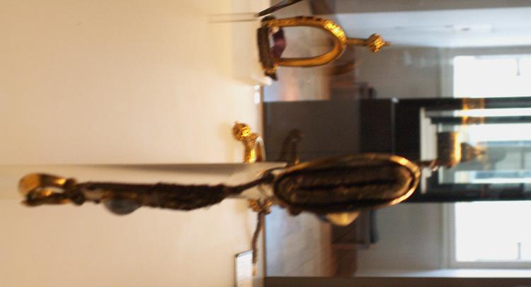

PostPosted: Fri 31 Oct, 2008 5:02 am    Post subject: Examples of XIV century longsword scabbards         Quote
Hi There,
I have now finished the wood core. Grey you were right! The scabbard is fine and has has survived an intensive cession of thinning, which was a perillous endeavor since my chisel work while hollowing the inside had been more than uneven. I’m now satisfied with the look of the core. I am aware that I have weaken the structure though, but it is still solid and I'm sure gluing 1.5mm leather on the all thing will bring it together. I plan to fill the few gaps I made on the core with milliput before wrapping the leather on. As for "being content to not be content" I realize that this is a wise piece of advice, but I'm afraid I am too stubborn to take advantage of it :)
Now time to move forward on this project and while I wait to receive the leather I ordered I wonder about the design of the piece. I have a pretty good idea of the overall look I'd like to achieve: a mix of some of fletcher's past work and peter johnson's scabbard for his swante sword (pic below). I had a very close look at it during a forge gathering near London that Peter attended. Now the Crecy is a typical XIV century sword...do you think that choice would be appropriate for it? I'm aware that the svante is a late 15 century sword but reproductions of XIV century long sword scabbards I've looked at seemed fairly similar in shape and design. For instance, the Brescia Spadona's scabbard, shown on the Albion website (the Brescia is after all another type XVIa) also exhibits a central ridge, no leather flap above the guard, and a similar suspension system.
Also It is my understanding that high medieval scabbards were quiet bare, with little ornaments compared to the previous era or the renaissance era that followed. But I wouldn't be against trying my hands at leather carving. So If you have pics showing decorated leather scabbard (or shown in artwork) from that period I'd be happy to have a look :)
J
edit: I stress the fact that the pic below is peter johnson's savante scabbard . Reading the thread I realised that it may be confusing...this is not my work, just what I am aiming for :)
 Attachment: 45.61 KB
Profile PM
PostPosted: Fri 31 Oct, 2008 6:52 am    Post subject:         Quote
My Sovereign scabbard's core has been mentioned a couple times in this thread, and I believe it to be on the thin side of normal. As long as it isn't too bulky and inelegant I think you're fine.
Check out the pic of the scabbard of the supposed sword of Charlemagne, posted by Manouchehr:
That scabbard is probably 13th century, embellished later. You can see it isn't too thin, though this is a ceremonial sword.
It doesn't have to be super-thick, though, like we see on many poor scabbards. The sword itself is much tougher than the scabbard, so it's not like some thin slats of wood have to protect heat-treated steel. :)
Profile PM E-mail Website
