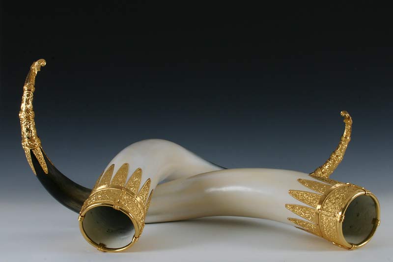

To complement the helmet, Dave has also made a pair of replica drinking horns. Owing to the fact that auroch's horns are no longer available he has fashioned the horns himself out of various plastics and other materials. they are enormous, 4 inches in diameter and 44 inches following the curves. The metal work is mostly made from the same method as the helmet plates but this time verything is heavily gold plated.
They hold more than five pints each -- which could represent a good night out!
Paul

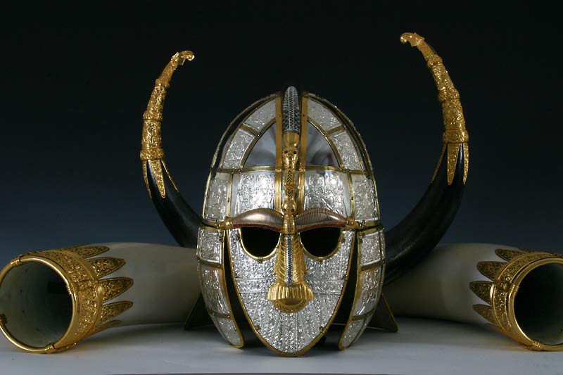

PostPosted: Sun 05 Nov, 2006 3:59 am    Post subject:         Reply with quote
Here is a picture of the helmet and horns together to give an indication of scale.
Paul

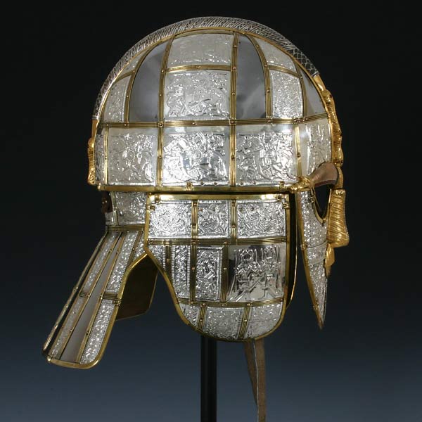

PostPosted: Sun 05 Nov, 2006 4:00 am    Post subject:         Reply with quote
And a side view of the hat!
Paul
