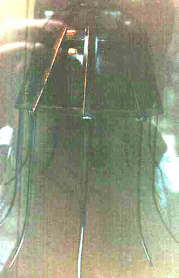

This is the only web-pic I can find of the elusive "Spider "Helm and its a terrible photograph ...it looks like a portable Bar-B-Que photographed in a storm at night !
This one is marked as 1650-1700 .
I would be very appreciative if someone could post any better pictures of this rather rare helm type. I'd also appreciate any additional data on who wore them.......cavalry I assume ?
Thanks !
 Attachment: 22.45 KB
Merv ....... KOLR

Yes, this is the front of the helmet. IIRC, a photo in the collection catalog shows the piece "cocked" as well.

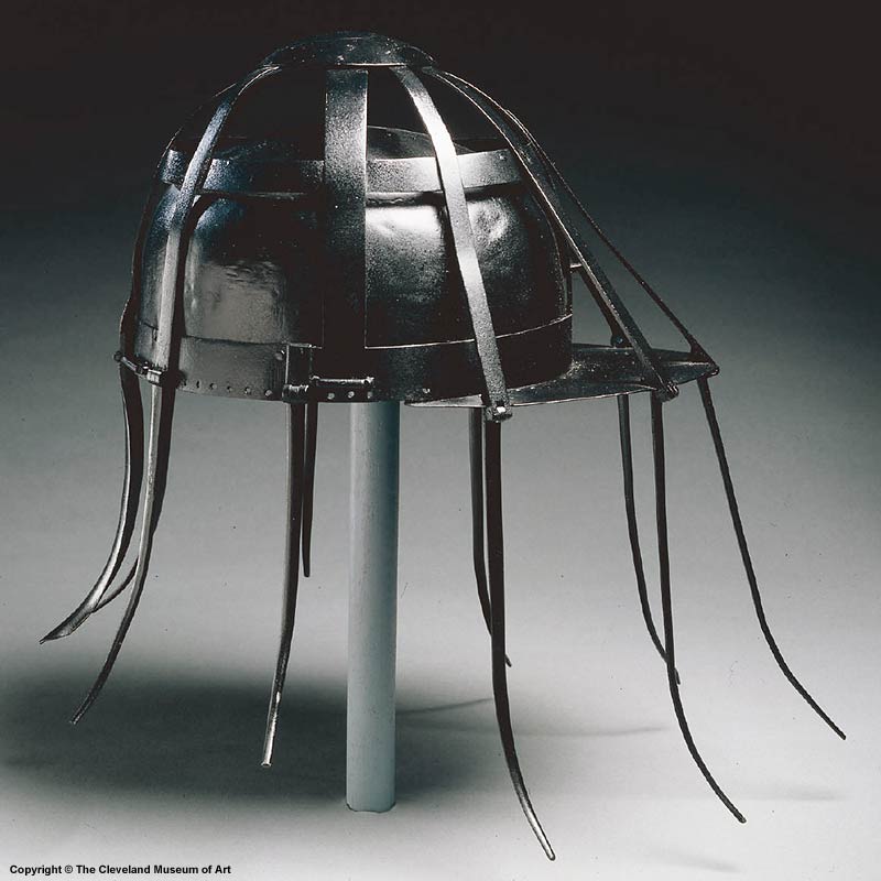

Attached is the spider helm from The Cleveland Museum of Art, 1921.1258.
Cavalry Spider Helmet
France, 17th Century
iron with black paint
In the configuration shown, the "spider arms" are down, in a position intended to protect the wearer.
 Attachment: 59.26 KB
1921.1258

The legs are hinged, often spring-loaded, and lock in place.

Thank you very much Nathan ! In my 5-6 years of web research-surfing this is the first non postage stamp sized decent spider helm shot that Ive seen !
