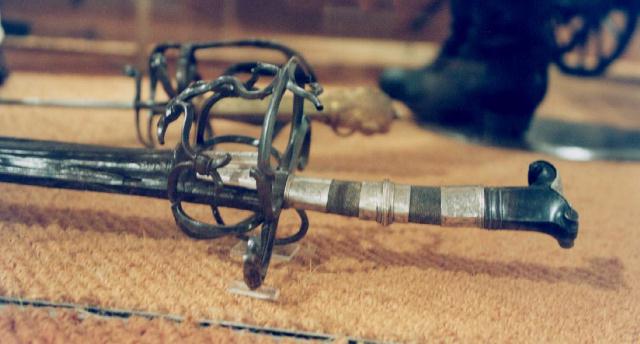

Attachment: 33.37 KB
Photographed in Basel Historisches Museum, Switzerland. Later than being discussed, with a less impressive guard, but a handsome piece..

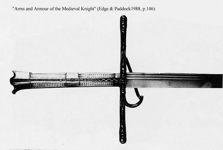

Peter-
This photo may help to get your point across. There are more photos of this type of sword in the myArmoury albums.
-Tim
-Tim

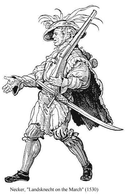

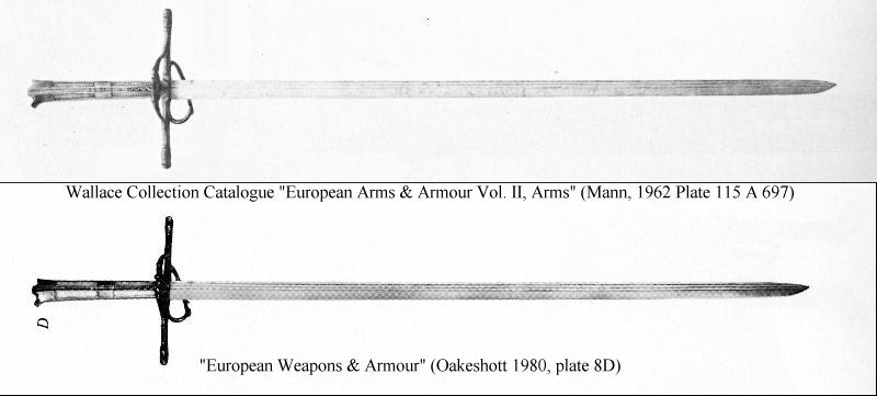

In the meanwhile, here are those two illustrations; not Schweizersäbel unfortunately, but interesting nonetheless.
Attachment: 107.47 KB
From "The Secret History of the Sword" by J. Christoph Amberger; original source unknown.
Attachment: 54.8 KB
From "Landsknecht Soldier 1486-1560'" by John Richards; Eli Tanner collection.
