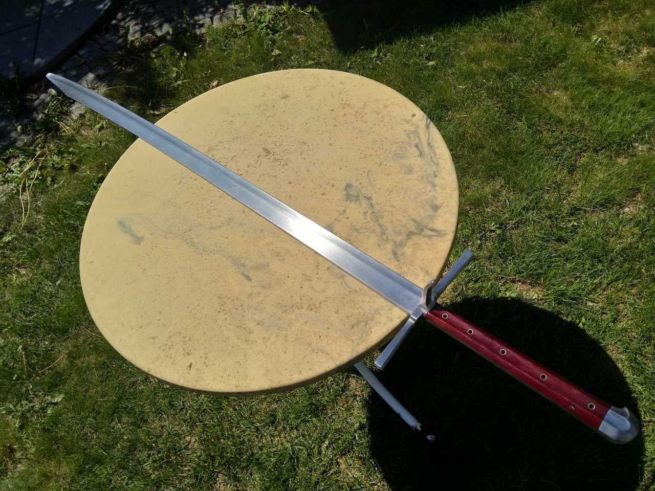

While Corona had the world firmly in its grasp, the team over at Landsknecht Emporium were still working diligently.
As such, the sparring Kriegsmesser I'd commissioned at the end of October last year arrived 10 days ago.
I had originally communicated with Adam from Landsknecht Emporium via Facebook in October, and he was very responsive and open to my questions. In November, I slightly tweaked the order, adding purpleheart handle scales instead of walnut for an appropriate markup. Not really historical, at least for the 15th century, but it just looks amazing. Upon inquiry I got updates at several points during the process.
They are looking to add sparring Kriegsmessers to their catalogue, but are still in the prototyping phase and gearing up in the shop. As such, my Kriegsmesser is slightly different from the first one that appeared on Facebook in July last year, as well as the one used by Mila/@Messergirl and the one they had as a prize for a tournament last year.
First impressions were a bit of a mixed bag, sadly. The Nagel had pierced through the packaging during transport, and I'm pretty sure the small ding at its tip resulted from that. Adam said that there should have been thermoplastic material protecting the Nagel, but unfortunately that seems to have been forgotten. The Messer was packed between two sheets of cardboard, wrapped with black packaging film, with extra bunched-up cardboard in the Nagel area. The blade didn't pierce the package and didn't slip or get damaged in any way, but the Nagel punched through and took a hit.
I think they could do better, considering the price range.
Overall the piece exudes the same rough-around-the-edges charm that all LKE products have, but in some places I feel that it should have received more cleanup. I am being a more nitpicky than with their other offerings, simply because it's three times the price.
The grind of the blade is overall nicely even and smooth, the lines more symmetrical than on my Gottfried blunt. I love blades with a satin finish, and this one is overall pretty good. There are a few places where some grindmarks remain visible, but many of those will go away with use and cleaning, and they also don't look out of place from a historical perspective. It is a sparring tool, after all.

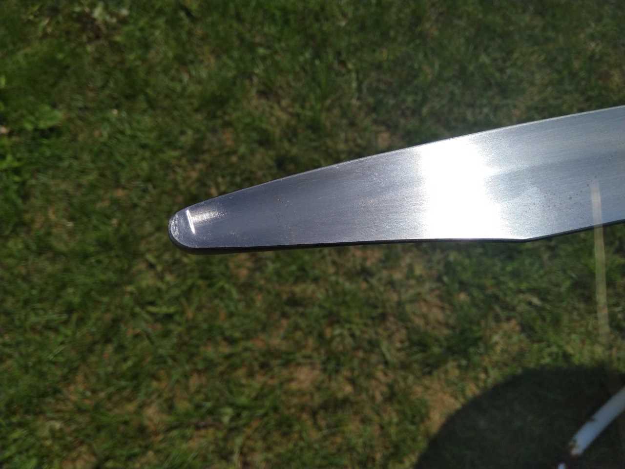

Unfortunately there is an unsightly step that does stand out right before the heavily reinforced point on either side of the blade. Adam agreed that he should have cleaned that up better.
In other aspects I have to praise the grind: The distal taper is spectacular. The massive thickness of the base material was a big selling point for me, as it's rather rare to see this historically relatively common feature in reproductions. As far as production pieces go, I‘ve only seen it in Albion‘s discontinued Knecht and Nielo Swords‘ Kriegsmesser offering (according to KultOfAthena‘s descriptions).
I've measured the spine in several places:
Base: 8.2mm
15cm from the cross: 6.0mm
45cm from the cross: 3.8mm
At the clip near the point: 3.0mm
Reinforced point: 7.5mm
The edge has a thickness between around 3mm at the thinnest point and 6mm at the base. It should be extremely resilient. It is rounded off pretty well. After some initial testing in techniques and freeplay it seems to hold up as well as expected. We were only fencing in very light gear (light gloves + masks) and my partner was using an Aureus Feder, which is very hard, but has a very thick edge. Still, there was a good bit of force in a few of the engagements and drills, so I‘m confident that the edge will hold up very well. The spine, as it is just a slightly chamfered rectangle, takes more notable damage, but nothing I‘d be worried about.
There is no "fake" false edge bevel, unlike with previous prototype LKE Kriegsmessers. I like having a short back edge, and it had been a feature on at least one of the earlier prototypes they‘ve shown on Instagram. I wonder if they found it to be too rare in originals, or maybe if there aren‘t actually any original curved Kriegsmesser that sport a false edge to begin with. Either way, I'll probably end up personalising mine a little by adding a faux-false-edge by rounding off the spine a little.
At least one of the previous generations of prototypes was made from 6mm stock, this is now the 8mm version. Oh yeah. Grinding the thick material is also where the added cost mainly originates from. I‘ve been told that, with the equipment they had late last year, it took around five times as long to grind a KM blade compared to a Gottfried, so the price hike is understandable.
The blade did not come out perfectly straight, but the bend is pretty minor. I'm not concerned about the structural integrity because of it, and it doesn't seem to impede the handling of the Messer.
Speaking of the handling, let's talk about something that's very unique about the Kriegsmesser.
In one of the instagram posts about sparring Kriegsmessers, it's been said that they've internally been called "The SUV", because they'll go through pretty much everything. I've only once so far had the chance to do some training with a partner so far, but I can already attest to that. Its inertia makes it quite domineering in a bind. It also hits like a truck, but thankfully, I have sturdy training partners.
It is heavier than previous prototypes at 1650g, with the center of gravity a few centimeters closer to the hilt at 15cm. They've experimented with the flex as well. The first iteration was allegedly a bit too floppy, while the second one came out overly stiff. I think this one is perfect. It's still on the stiffer side, but I prefer it that way, and it's not for tournament use anyway. It's stiffer than both my sharp and blunt Swordmaker Marienburg Longswords, which are on the more flexible end for „real“ swords.
With 24cm of handle and 94cm of blade, it is not an easy blade to wield. It's also not exactly light, with the balance further out than any of the other long swords I've handled, so it ends up feeling pretty choppy. Trying to force it instead of working with it will end up hurting your joints and tendons more readily than with a lighter, more nimble sword.
This isn‘t necessarily a bad thing, though, as it reinforces the importance of proper technique and makes that an even more important aspect of my training routine. It is intimidating in a bind, and while it's not really suited to "Meyer's Helicopter of Death", it flows quite nicely once you get used to it a bit.
After solo-training with it for a week I have become quite comfortable with it. It no longer puts undue strain on my arms (part technique, part conditioning) and flows through motions with mighty authority, while other, less hefty simulators just feel weird and whippy by comparison.
I have managed to get a tiny amount of partner work done, just a few master-cuts and a little gloves-and-masks freeplay. Displacing cuts against it are almost futile.
Trying to do a Krumphau against the KM, my partner didn‘t get the point off-line and would have ran into my point when closing in for a followup. You‘d need to hit the center section of the blade with quite a bit of force to have any worthwhile effect.
Executing a Zornhau-Ort combo or a Krumphau with the KM against his Aureus Feder (which is no slouch itself, mind you) easily transferred enough momentum to his blade and left a giant opening.
I have not tried a Zwerchhau (at least, not with the intention of hitting him), because I am very worried that, if I hit him with the clip of the spine, I‘ll end up knocking him out through the mask, or at least give him a concussion. Its impulse is scary. I might do some Zwerch-practice with someone wearing a Bohurt-ready helmet, but a mask alone is too risky for my taste right now.
Freeplay needs to happen with a high degree of control, with or without gear. Accidents can happen even at lower intensity and with both parties being careful, so I would always recommend good finger protection as it can damage a thumb with more or less incidental contact.
I‘d liken it to the LKE Liechtenauer Feder, which Dave Rawlings did a nice short video on, and came to pretty much the same conclusions: https://www.youtube.com/watch?v=iqNGzrb4o8A
This is likewise not for sparring with people who do not know what they are getting into, and most certainly not for tournament use.
Overall it does indeed feel more like a serious fighting weapon that packs a good wallop in battle, rather than a comparatively dainty dueling implement.
While I haven't handled any original Kriegsmesser, I'd say it could be considered a slightly scaled-down version of the "Maximilianisches Kriegsmesser" ZEF-3-MS2, which was documented by the Zornhau e.V. group:

Some more measurements on my LKE KM:
Overall Length: 120cm
Blade Length: 94cm
Weight: 1650g
Center of Gravity: 15cm from the cross
Centers of Percussion:
Handle node: 1cm behind the guard
Blade node: 27cm from the point
perceived pivot point: 15cm from the point
Hilt length (usable): 24.5cm
Quillon block length: 1,5cm
Nagel Height: 6.8cm
Cross width: 19.8cm
Width of grip: 2.65cm ~ 3.35cm, linear increase towards pommel
Thickness of grip: 2.0cm ~ 2.6cm, linear increase towards pommel
Width of blade: 4.0cm at base, quickly tapering to 3.5cm, which it pretty much maintains until the clip.
There are only few flaws with the blade that I do mind: The aforementioned step near the point should have been cleaned up, and there is a set of deep scratches where, I assume, someone slipped with the grinder while flattening the Nagel‘s peen. Everything else about the blade is fine.

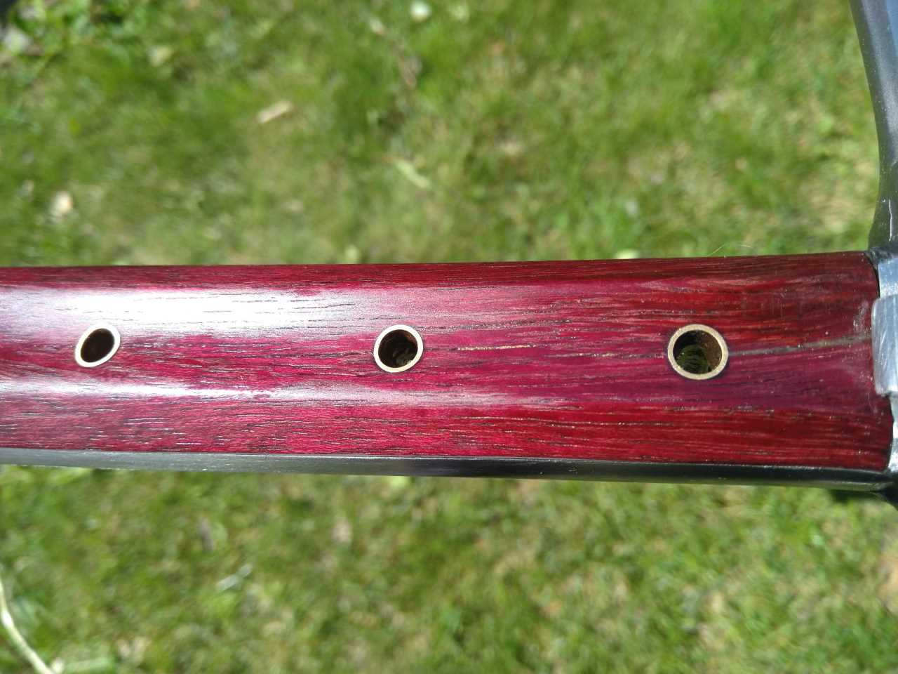

Moving on to the hilt. The handle scales are beautiful, the purpleheart really pops in the sunlight. In darker conditions it‘s more of a dark purple, which is still unique and beautiful. There was apparently a small crack or crease on one side, which has been patched. I‘d also like to point out that some of the brass from the tubular rivets got stuck in that patched area, giving it a small golden glitter. I like that accent.
The hollow brass rivets are pretty well finished. They‘re entirely flush with the wooden slabs, though one of them sits on the edge of aforementioned cracked section of the handle slabs.
They are extremely comfortable to grasp, and the transitions from wood to metal can barely be felt. I also like the added girth compared to the single-handed offerings.

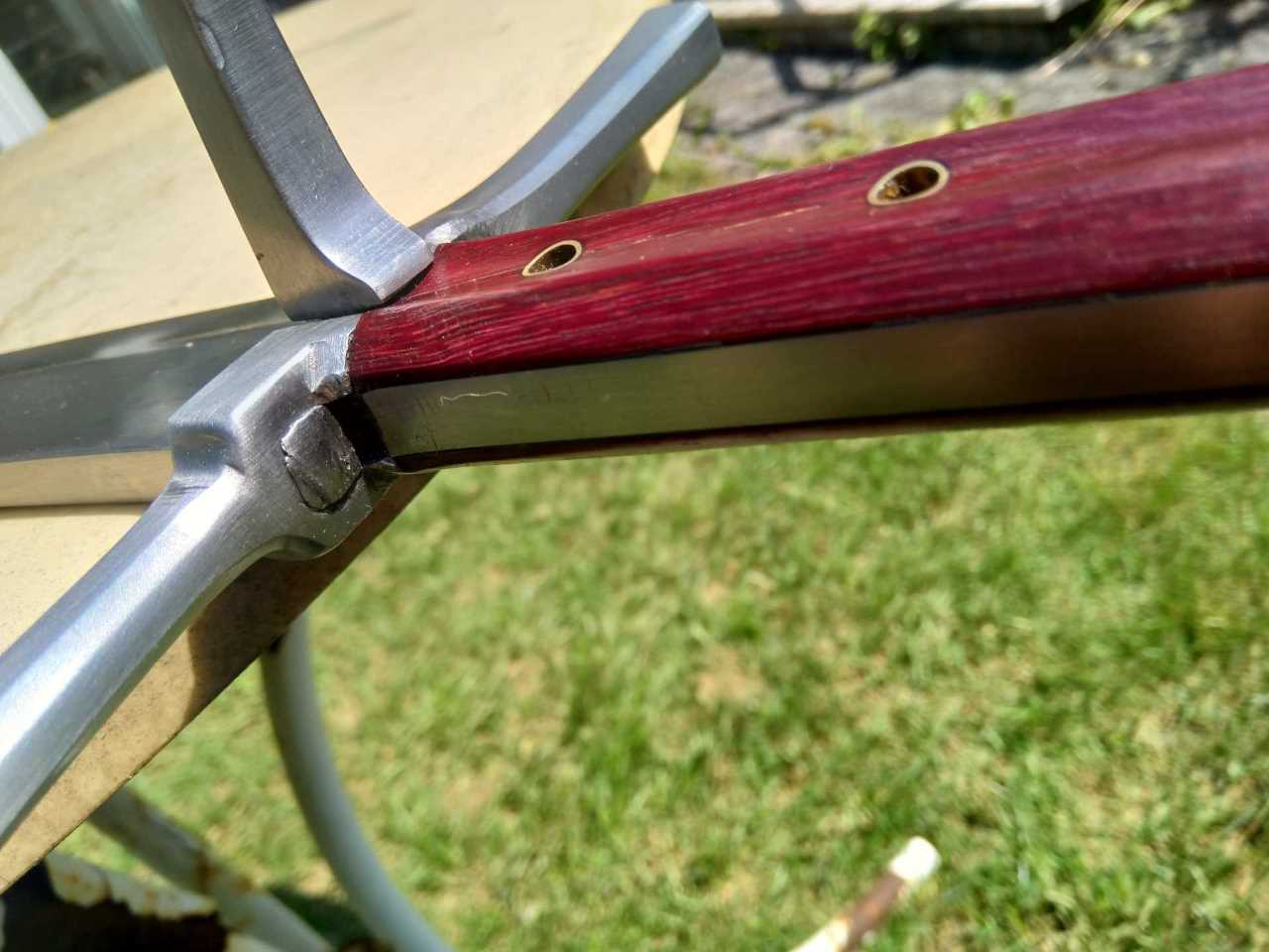

The crossguard is substantial, notably thicker than on the single-handed Gottfrieds. It has also been back-peened to the blade, which should make for substantially better durability rather than it loosening after its first evening of bouts. Very happy with this change, and it‘s executed fairly cleanly and well.

The peen side is also a mixed bag. On the one hand the Nagel peen was ground flush, as opposed to my two Gottfried Messers, where the „rivet“ is slightly protuding. I don‘t mind the rivet, but the flush version is undeniably more comfortable to „thumb“. Unfortunately it was also cleaned up less diligently. There are even more unsightly creases, dents, and discernible angle grinder marks on the KM than on the Gottfrieds, despite this clearly being a part that shouldn‘t take significantly more effort to clean up on either type of Messer. Doesn‘t bother me as much as the sloppily bent Nagel, though. Perfectly fine for 300€, but not what you would expect at the given price.
I‘ve communicated my gripes to them, and they were rather accomodating, so we reached a mutually acceptable solution. Everyone makes mistakes, but it‘s important to own them and learn from the experience.
