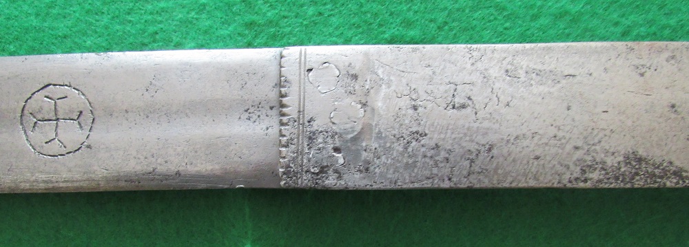

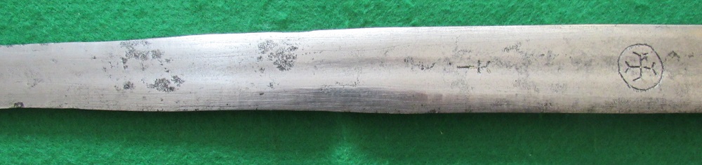

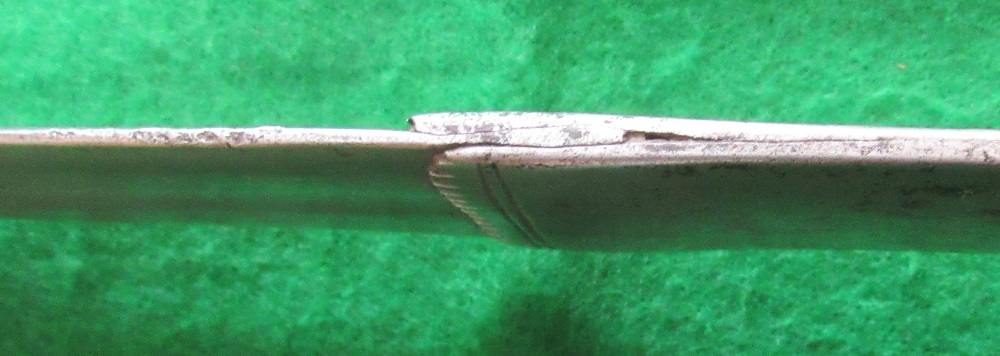

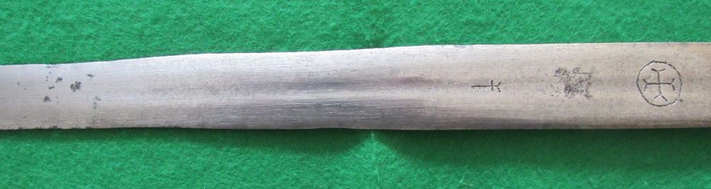

Teodor Vacev
Joined: 04 Aug 2004
Posts: 7
PostPosted: Mon 16 Dec, 2019 10:03 am    Post subject:         Reply with quote
Craig, I appreciate the effort you are putting in this thread. It is important to examine this sword for what it is. It is NOT a European medieval sword in more or less its original condition, and therefore should not be looked at as such. For example, the forte is not the original forte, but a sandwich construction made in the Sahel in the 18th century for the purpose of attaching what was left of the blade at the time to the hilt. To evaluate the sword based on the forte would be like evaluating it based on the hilt - both were made in Africa centuries later. As for the fuller, I probably owe you better pictures of that area from both sides of the blade.
Teodor Vacev
Joined: 04 Aug 2004
Posts: 7
PostPosted: Mon 23 Dec, 2019 12:58 pm    Post subject:         Reply with quote
Here are some pictures of the fuller, as well as acouple of pictures showing how the blade was inserted into the forte and riveted.
 Attachment: 110.82 KB
 Attachment: 98.71 KB
 Attachment: 153.78 KB
 Attachment: 131.42 KB

Fascinating piece. Reminds me of some of some Kaskaras made from European blades. Given the context, the origin story seems plausible to me.
