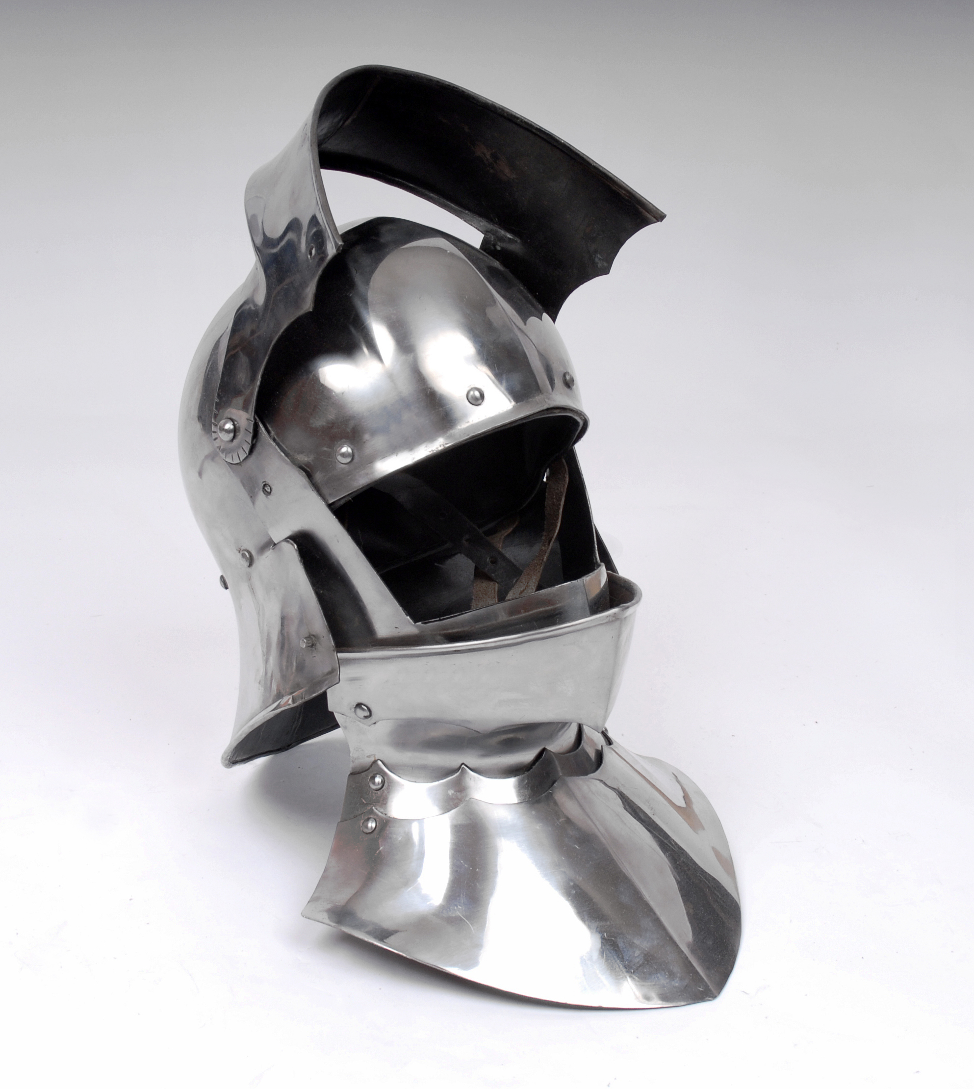

The link has pictures of several museum pieces that have falling-visored sallets. I've seen no arguments that use of a falling visor is an ahistorical method of sallet design. A search for "visored sallet" or "gothic sallet" should lead you to many modern and historic examples.
As for the bevor, my sallet/bevor combo uses a "falling buff" bevor - the visor on the helmet lifts, the buff on the bevor lowers. If made properly, the bevor, like any other piece of armor, will provide protection without impeding movement - just think of it as a gorget with a chin-cup (which is what it is). It doesn't hold your chin in place - there's plenty of room to turn your head if it is made correctly. If fastened correctly, it remains stationary while your head and sallet move.
As for "complicated", I'm not an armoror, so I don't know how difficult it would be to make one; but, if you're skilled enough to make the visor and helm, you are likely skilled enough to make a bevor.
https://www.pinterest.com/nicharrison39/sallets/

Ahistorical, but also an existing design/SCAism due to the annoyance of a bevor and various HEMA group rules about helmet gaps and the like. Darksword armory has been importing something similar for quite a long time.
The historical solution was to nix the bevor entirely; que bellows face sallets and proto closed helms

In my experience the bevor is essential for the salet to function properly, almost like upper and lower halves of the same unit. I wouldn't worry too much about a lack of movement, I've fought in a bevor/salet combination and it offers much more articulation about the neck than a lot of other contemporary helmets. The only helmet I can think of that's more comfortable and maneuverable with a bevor is a kettle hat.
As previously mentioned later salets subvert this problem by becoming more complex and enclosed e.g in the case of the bellows face. However depending on your needs/period of interest this could be too late, as well as the fact that the salet you've designed is representative of the vast majority of historical examples, even visorless salets are more common in later periods than bellows face examples.
