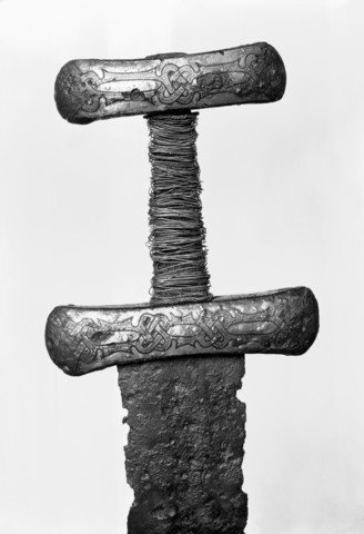

Here is another example from Norway, of classic 10th or early 11th century form (Petersen's type S, with missing pommel cap) with a noticeably short fuller. I think there is no reason to suspect this sword of having been altered, re-profiled, re-hilted, etc.
Very little is truly unique - whether these blades are an experiment that came before its time, or the preference of one or a few eccentric smiths, or a subtype that existed for centuries before gaining popularity, there will surely be more examples to be found. It reminds me in a way of a similar pattern with double-fullered blades, that likewise occur sporadically on Viking age and early medieval swords, until a (minor) spike in popularity particularly in Eastern Europe, and in late Medieval blade forms.

Mark, this is very interesting sword. Do you have any more pictures or info?
Btw, we have to keep in mind that all these swords are late viking age swords when new types appear... Geibig type 4 is also quite tapered design of blade, but still with long fuller. Early type XI blades also start to appear in this period... The fittings on that Oakeshott type XII could be as late as early 11th century.

Hi Luka,
This is actually one of Petersen's original exemplars for type S - item no. C22138 in the museum in Oslo. It's illustrated on page 145 of De Norske Vikingesverd... I don't think Petersen makes any mention of the unusual fuller, but it's not so surprising since his classification is based only on the hilt. It comes from a burial in Hedmark county, but I don't know if the site is dated any more specifically than the general time frame we can infer from the sword's type.
There are high-res images in the museum's photo archive. Wink
http://www.unimus.no/foto/#/search?q=c22138
http://www.unimus.no/arkeologi/#/detailsView?search=C22138a

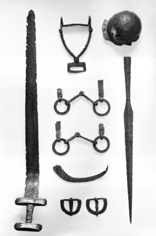

Hi Mark.
Found a short Norwegian article about the sword find at Vesterhaug - the images you included above are the same as the one in this article.
Source: http://www.loten.kommune.no/getfile.php/Bilde...nalder.pdf
You had farm Norderhov which contained a big burial mound called Vesterhaug.
Norderhov means the "hov" of Njord. While a "hof" in modern Scandinavian languages means a "court" of kings and nobility it probably meant a "small house for a god" in the Viking age -> today specified as "Gudehov" in the literature (like the one found recently at Tissø, Denmark). So the place name shows a pagan origin for the farm.
It was examined in 1918 and the burial mound actually held two different burials - so a reused mound, which is quite common in Scandinavia.
Oldest was a burial from the Iron Age (Merovingian Period) and the younger burial was from the early viking age (750-850 AD).
The viking age burial was a typical "ryttergrav" where artifacts connected with horse riding was found with the sword (as well as a spear and a shield boss).
PS: I would personally think that the similarity with the chamber graves found in Denmark from the Jelling Dynasty period (before Christianity was introduced) ~925-975 AD seems more likely as S-types swords are very typical for the Danish graves of this time period as described by Anne Pedersen in "Dead Warriors in Living Memory - A Study of Weapon and Equestrian Burials in Viking-Age Denmark, AD 800-1000" (2014).
