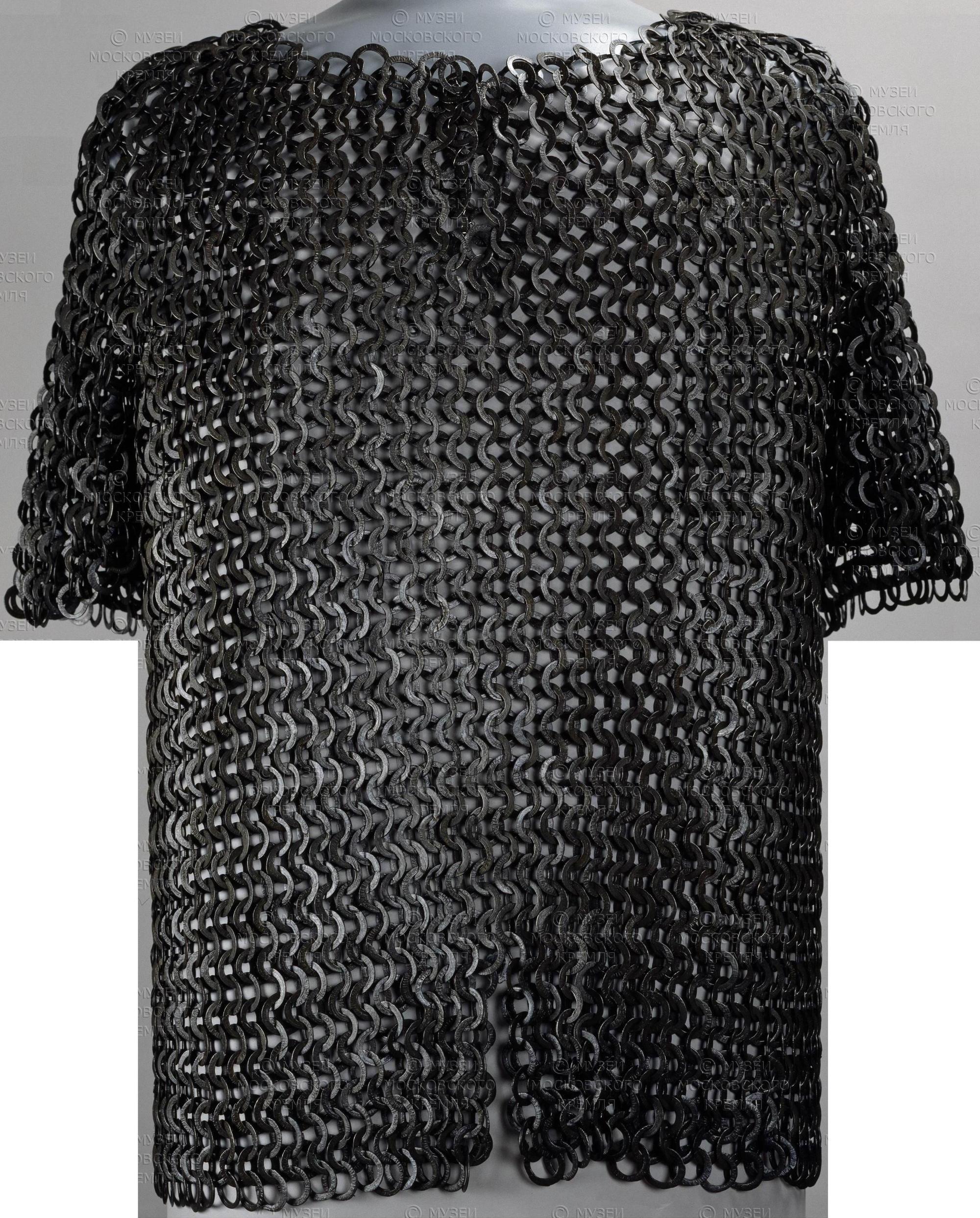

Hi guys. I found this russian style Baidana mail shirt picture from pinterest and it says its from Sweden.
Anybody knows where is it??
I have made request to livrustkammaren but it seems that it is not from there.
any ideas????[/img]
regards. Peter

1. The shirt in Sweden looks absolutely european to me. There is a very fine quality cut on the front of the skirt. Rings look like they are punched from sheet metal.
2. What would suggest it to be russian? There is only one russian shirt to refer and its the pictured one with flat rings but all of them are with text and seem to be joined or flat riveted. Looking at this russian shirt makes me think its very low quality construction and not compareable with this swedish shirt.
3. There is one more shirt to study in some previous thread. It was sold by ashoka arts a while ago with decorated solid rings.
This shirt appears to be more Italian commercial style adapted to persian market. Riveting seems to be european with square triangular bottom.
Is there any other shirts with: decorated solid rings, flat solid rings made of sheetmetal by punching like the swedish seem to be. Is there any other russian baidana shirts pictured to make comparison??
What would be date on the swedish shirt as solid rings should be normally early feature? Pre 1430?

I got answer from livrustkammaren. 22284 is not this shirt in the picture.

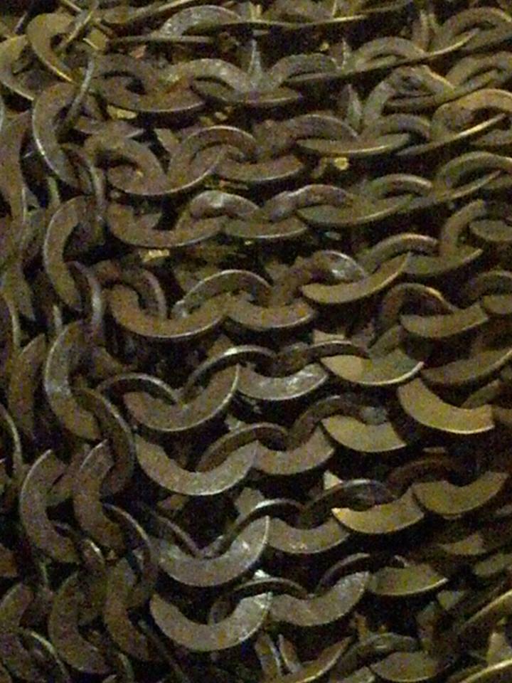

Here is additional picture from the bottom of the rings. Looks like wedge bottom to me. At least not rounded in the style like oriental round riveting where rivet is very round on both sides.

I concur - Euro wedge rivets. The question of how far eastward this form extends is undetermined. This use of wide, flat rings might be a style centered around the Baltic, though we don't have enough evidence to be sure.
I don't see a lot of similarity with the more modern Russian mail. Compare the rivets and overlap flare from the 6:1 mail standard in the British Museum:

Peter, if you had posted this picture in the first place there would not have been any guessing WTF?!
