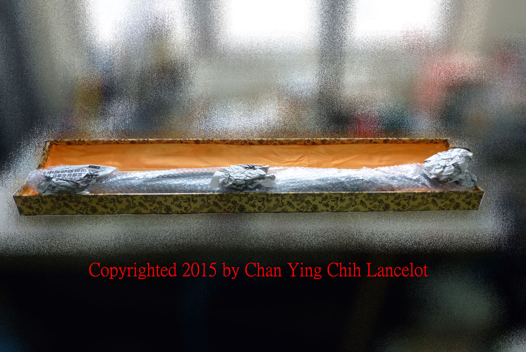

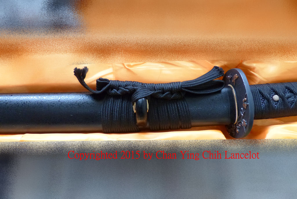

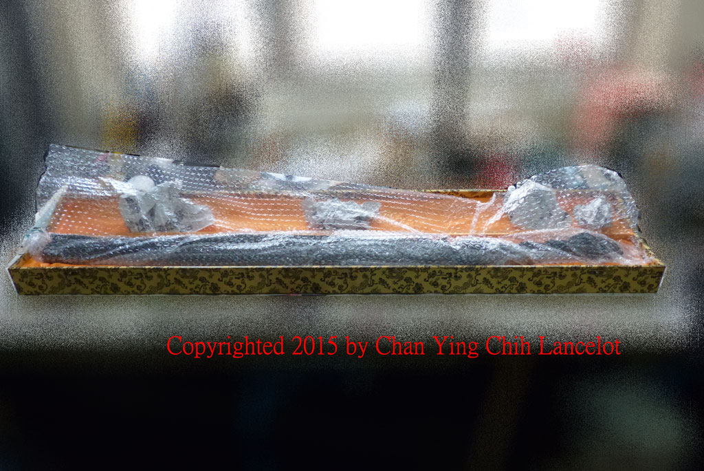

Shown above is the box that came after I unpacked the cardboard box.
The sword was well packed inside the box, with newspapers and bubble wrap to protect the item.

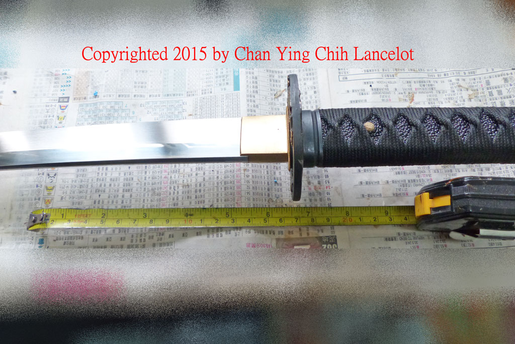

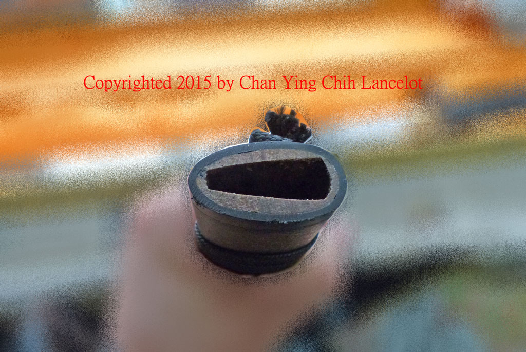

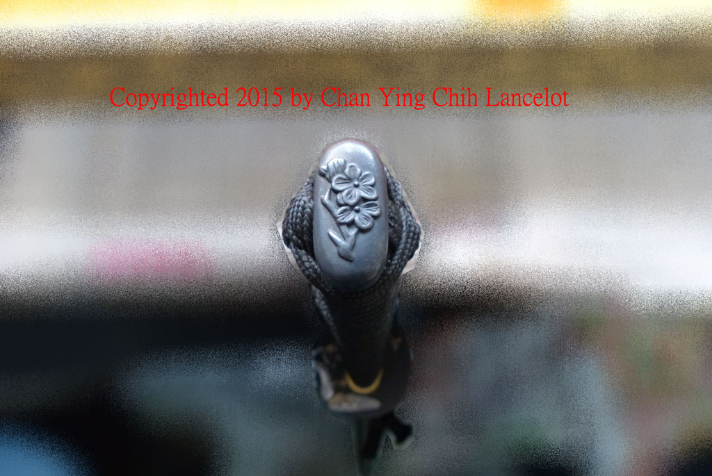

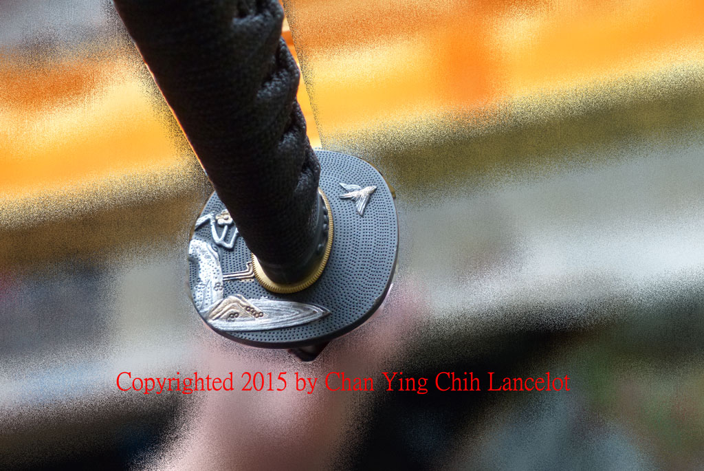

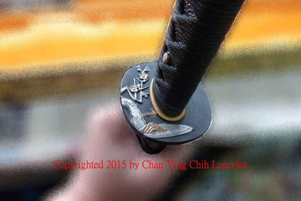

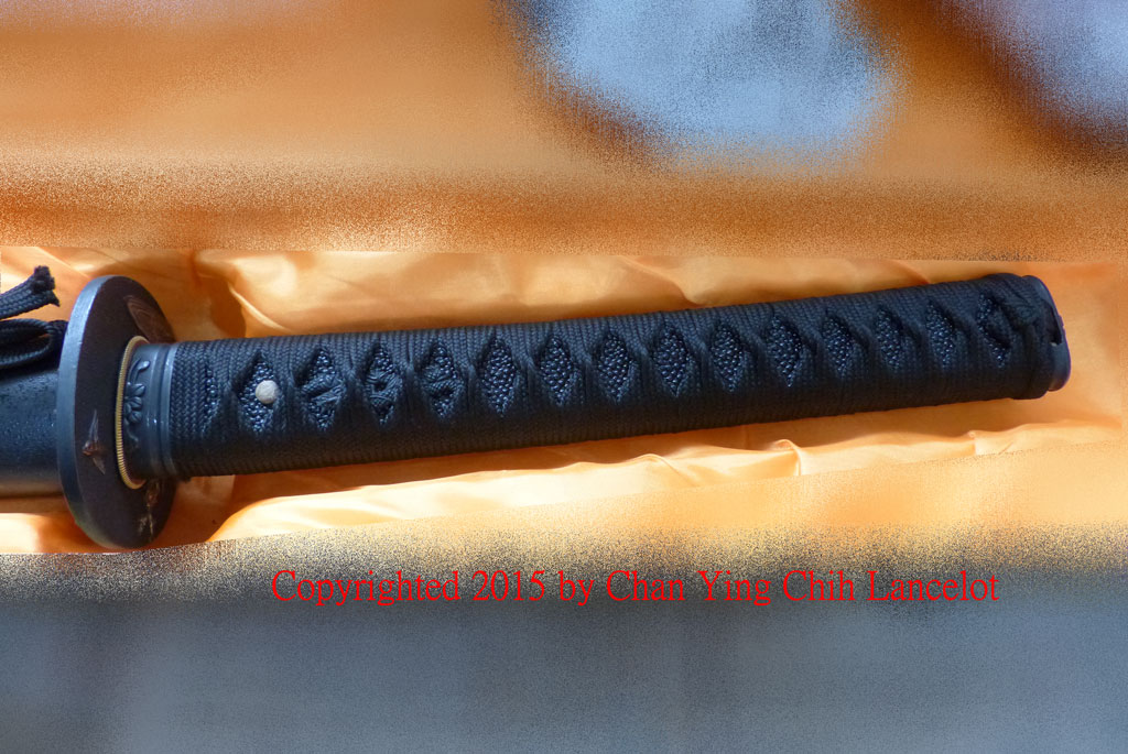

With the wrapping removed, I took photos of the hilt, the sheath as well as the fittings. They are all nicely done
and fit very well. No looseness out of the box.
Hilt:
Sheath:

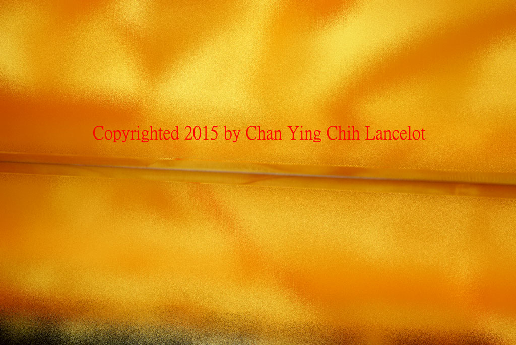

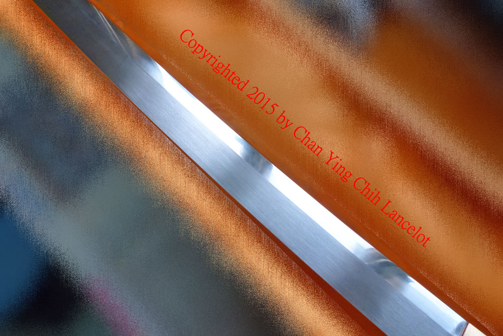

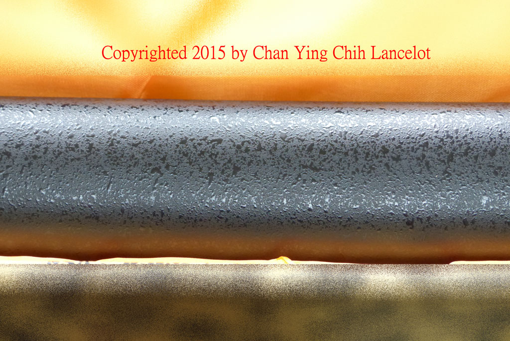

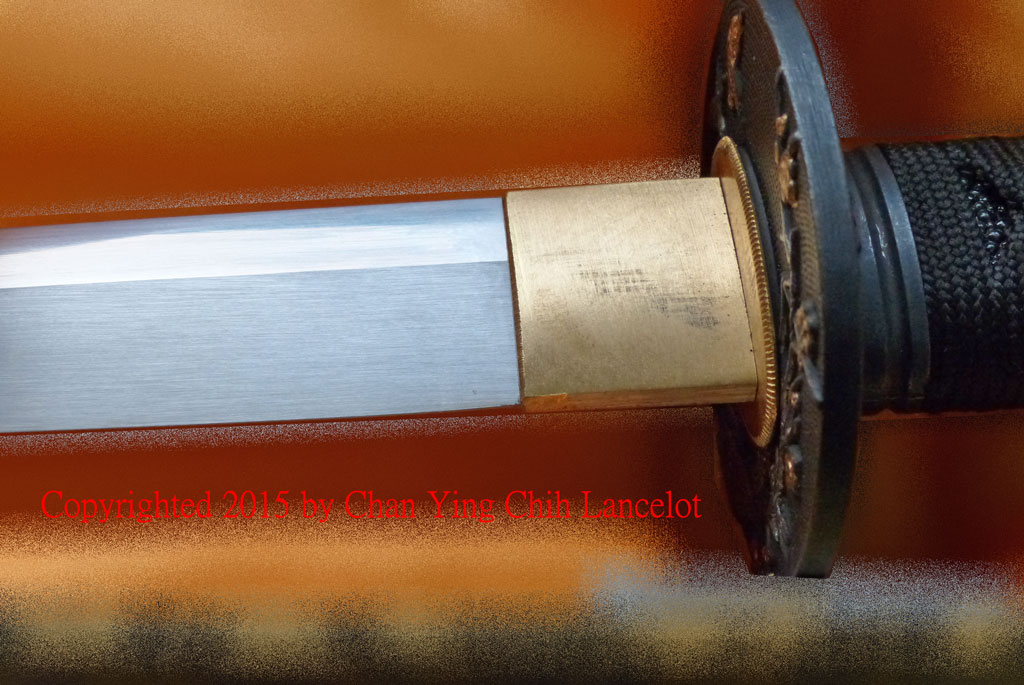

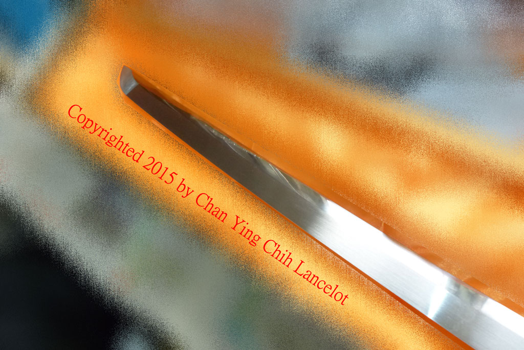

The blade features a hybrid polish. The edge bevel has a satin polish that is easy to maintain. One might scratch up
the blade in cutting practice and can easily fix the polish oneself by using scrotchbrite. The blade flat features a
higher polish that is almost mirror, which will resist humidity building up and resists rust better.
Blade:
At this price level, it is understandably that the yokote is purely cosmetic.

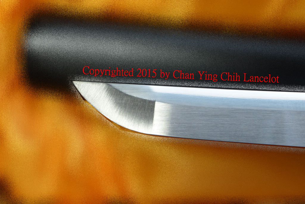

The edge bevel is a flat convex grind, which is a nice surprise where the majority out there were flat grind.

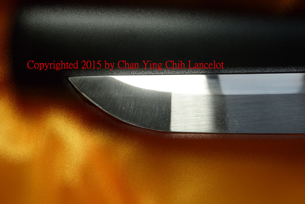

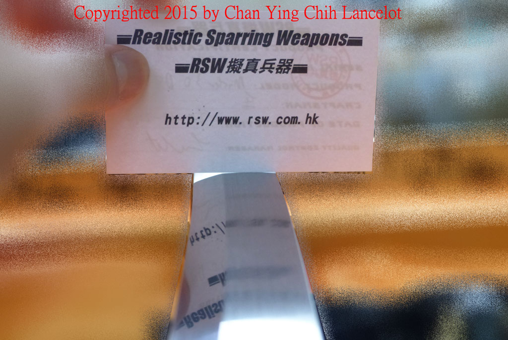

The edge also came sharp enough to cut paper. I took photos of the edge to show that there were no light reflection
on different portion of the blade.
Edge:

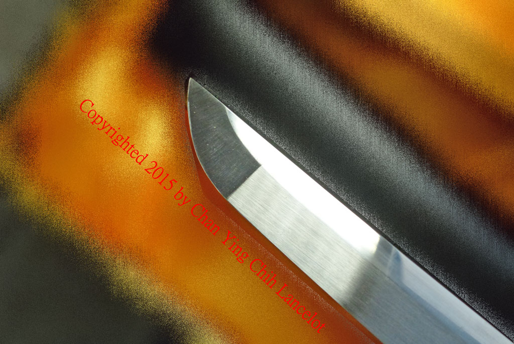

The base of the blade shown a blunt section, which is normal. Then from this point on, there was no light reflection
along the length.
I used a spotlight to light up the area but still no light reflection.

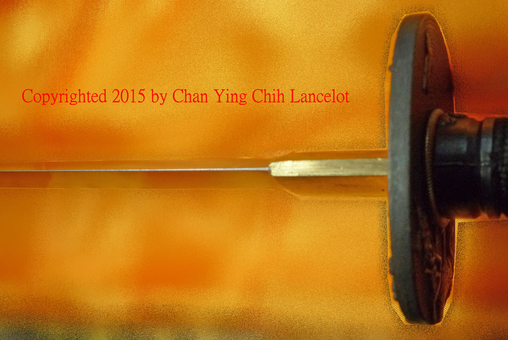

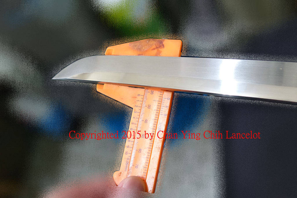

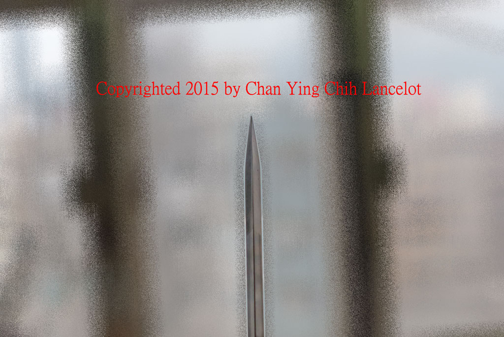

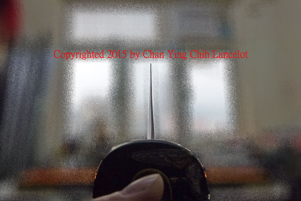

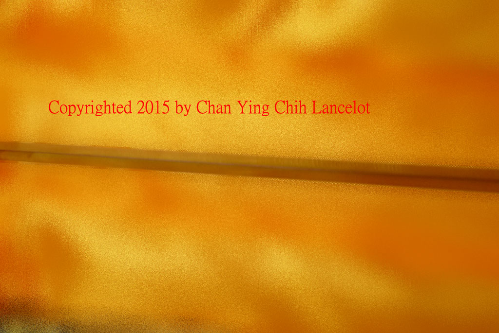

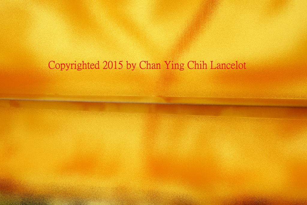

The blade came straight, and the edge line was done very straight too. This is the part that highly impressed me
because I have handled many swords, including custom made ones by master smiths in North America. The straightness
of the edge line surpassed some of those I owned.
Straightness as seen from the spine.
Straightness of the edge line.

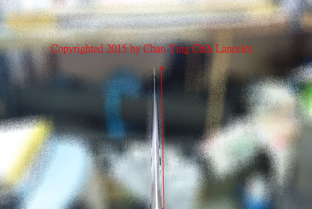

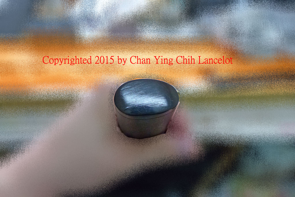

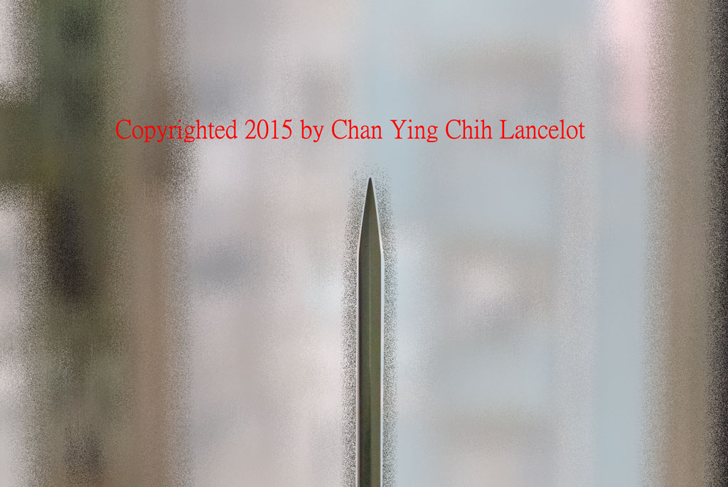

Symmetry of the sword tip from the spine.
Symmetry of the sword tip from the edge.

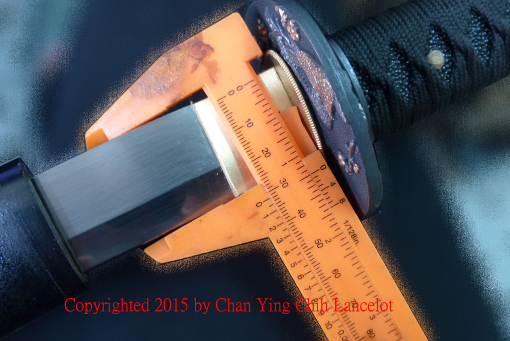

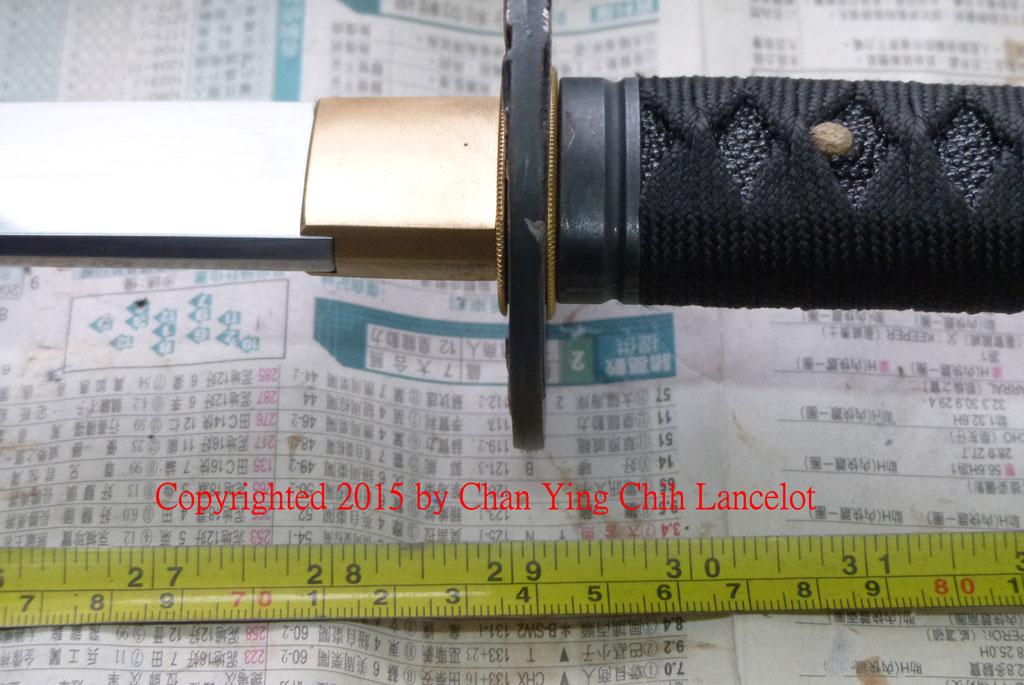

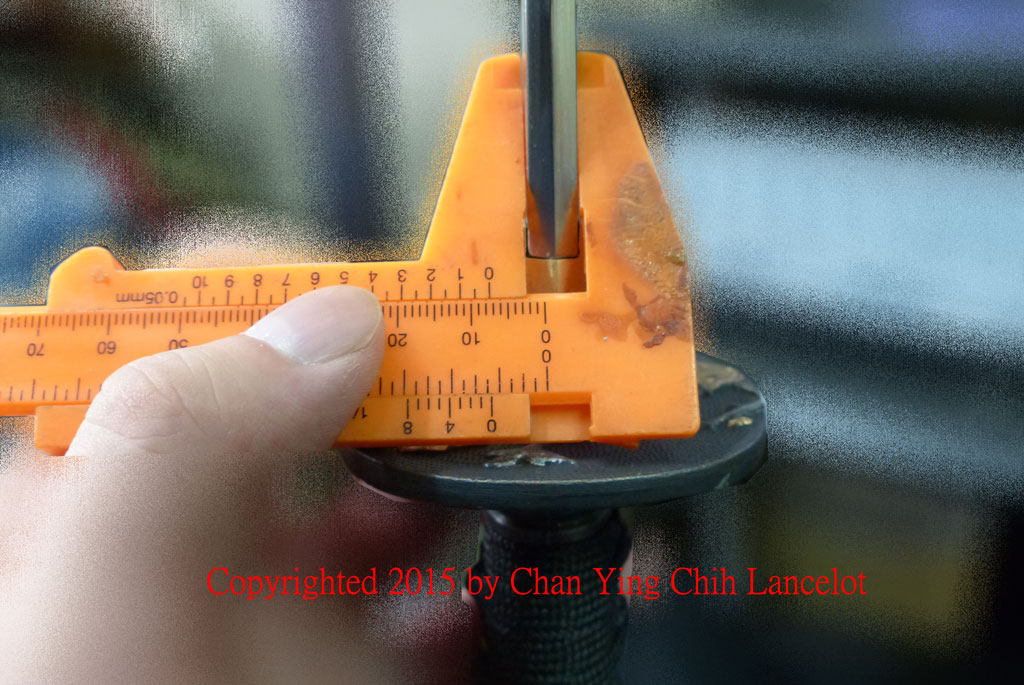

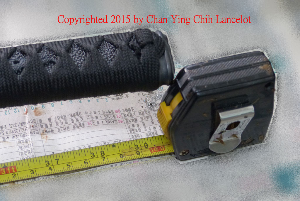

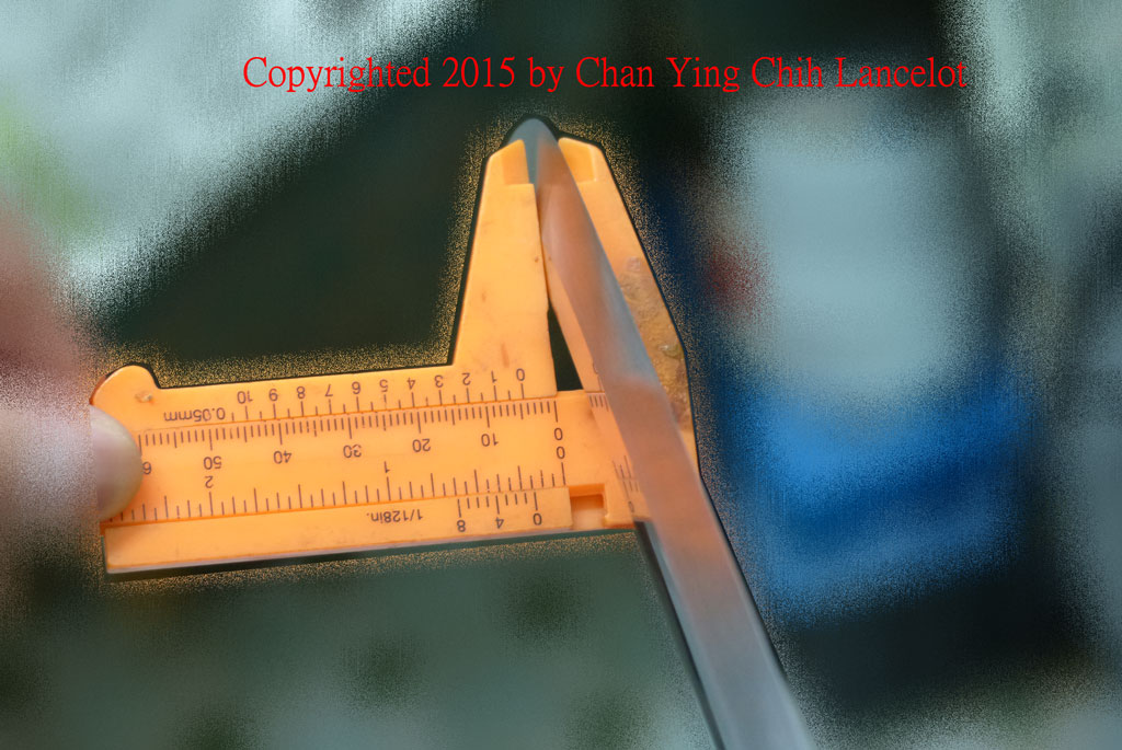

The weight of the sword is 980gram.
The balance is 6.5" off the guard.
The width at base is 1.25".
The width at tip is 0.9".
The base thickness is 7.5mm.
The tip thickness is 4.5mm.
Overall length is 39.5".
Blade length is 29"
