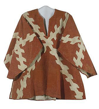

This is the garment I am referring too: Notice the Duke of Brittany
Extant example:
Was this a garment used only be heralds or would folks actually fight wearing these?

Tabards weren't always sleeveless -- sometimes they had sleeve-like flaps but the bottom seam along the sleeves isn't sewn closed, and (in many cases) neither are the sides of the garment's body, so the garment as a whole cut like a very loose coat but worn more like a cloak/cape. Modern officers of arms (kings-of-arms, heralds, and pursuivants) still regularly wear tabards whose design has changed little since the 16th century:
http://commons.wikimedia.org/wiki/Category:Heraldic_tabards
http://en.wikipedia.org/wiki/File:Bavarian_Herald.jpg
This thread has some earlier images (1490s) of the Knights of St. John at the siege of Rhodes in 1480, so they're probably more directly relevant to the 15th century or so: http://myArmoury.com/talk/viewtopic.php?t=8951&start=0
And no, I don't think tabards were replaced by "sleeved coat of arms" in the 15th century. If anything -- the tabard in the narrower definition (i.e. the ceremonial garment worn by heralds today and its direct ancestors) didn't seem to exist before the 15th century.

Ah so the pictures I posted are essentially tabards worn over armor. It would be great if we had some sort of standard terminology for this. Something denoting the construction and the things it displayed.
Thanks for the other thread by the way, you can clearly see the detail of how it was worn. It just leaves the question who wore what and when.

It's hard to tell. The shorter version (as in the illustration of the Hospitallers at Rhodes) wouldn't have impeded the wearer's movement much, so it could have conceivably been worn in combat -- though we have no clear-cut evidence for it. The heralds' larger tent-like version is obviously not suited for combat. That being said, a garment of very similar but somewhat more practical design (I'm not sure about the exact name, though I've heard the terms "cassock" and mandillion") was quite popular in the 17th century, and it appears that the Royal and Cardinal's Musketeers went into battle wearing them. Of course that doesn't really help in determining whether this garment was worn on the field in the 15th century!
