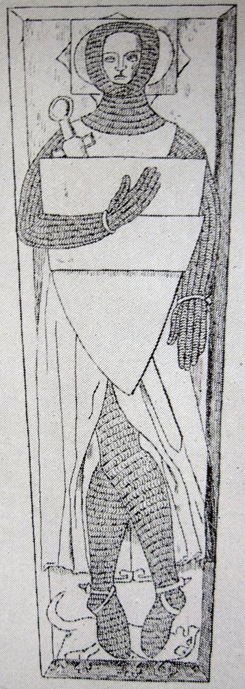

I've seen the dueling glove above, but I was wondering if there were any attempts to recreate the seemingly (likely lined) full mail cover gloves like these:
Just a few examples
 Attachment: 14.27 KB
 Attachment: 71.91 KB
 Attachment: 88.02 KB
All 3 types of mail hand coverings [ Download ]
 Attachment: 111.61 KB
 Attachment: 74.72 KB
