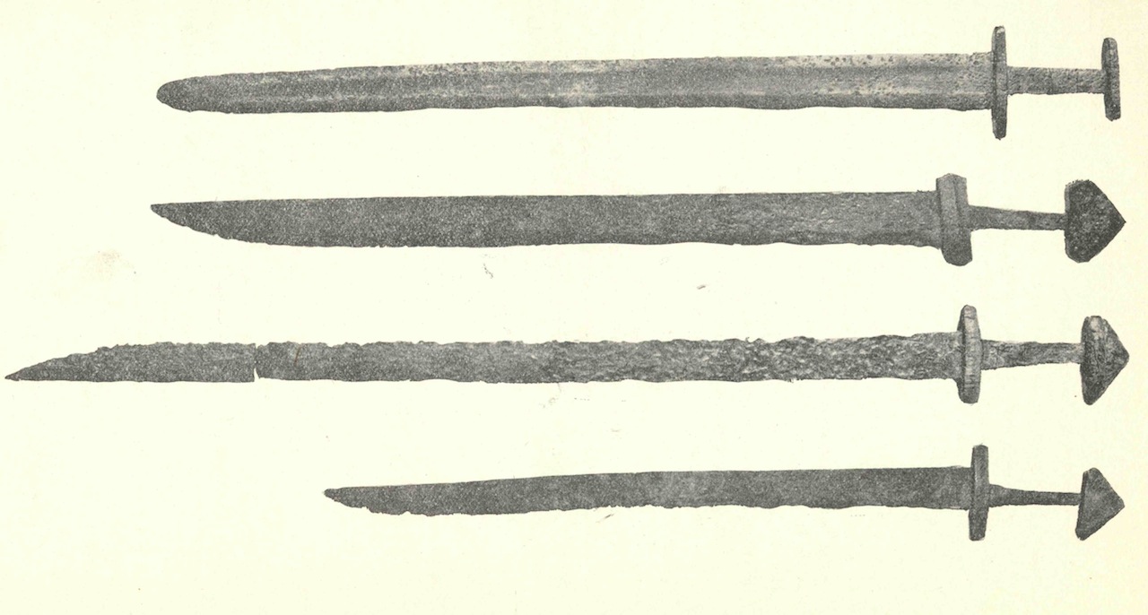

Elling Polden
Location: Bergen, Norway
Joined: 19 Feb 2004
Posts: 1,576
PostPosted: Mon 25 Jun, 2012 3:43 am    Post subject:         Reply with quote
Pettersen states that swords shorter than 70 cm are very rare.
Out of ca 200 measure blades:
Under 70 cm: 9
71-75 cm: 37
75-81: 136
81-90: 36
As such it appears that blades of less than 70cm could be found, but that they are so rare as to be "flukes" rather than a spesific type.
So, if you want one, you can have it, but be aware that it would be unusual.
 Attachment: 160.5 KB
Illustration from Pettersen: Two swords of average length, the longest and shortest sword in his material. [ Download ]
