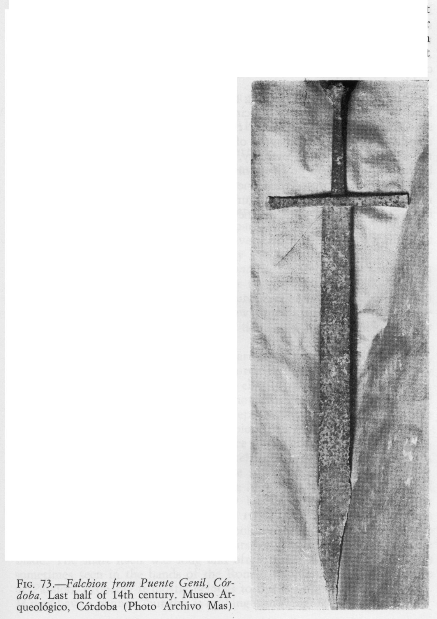

PostPosted: Thu 19 Jan, 2012 9:13 am    Post subject:         Reply with quote
The overall form and pommel seem right for that period. See the discussion here: http://www.myArmoury.com/talk/viewtopic.php?t...ht=cordoba
I don't know if anybody has learned any more about this. I checked the museum site at the time of that link and didn't find it. I don't know if anybody has tried to contact the museum, but if you contact them and get some information, please share it with us!

Sorry to dig up this topic from grave after like 4 years - but lately I got some news about the Cordoba falchion.
I actually found (on a russian forum) a photograph of it, it seems like it was the main inspiration for the famous Laking drawing:
Picture here
It comes from the book Arms and Armour in Spain II: A Short Survey by Ada Bruhn de Hoffmeyer. In the book there's a (somewhat scarce) description of it:
There exist, however, in the archaeological museum of Córdoba a falchion of a different type (Fig. 73), excellent in regard to conservation, found near to Córdoba in river Genil. This sword has a facetted pear-shaped pommel, horizontal and slightly S-shaped quillons and a long, solid single-edged blade, terminating in a yelman. In regard to blade it corresponds well with the so-called Thorpe-falchion in the Castle Museum of Norwich. This type of falchion, different to the Durham and the Catalan especimens, is probably—as said by Mr. R. Ewart Oakeshott about the Thorpe-falchion—of eastern origin. In regard to chronology of the Córdoba-falchion, its pommel and quillons indicate a period about the end of the 14th century.
After that I decided to contact the Cordoba Archaeological Museum, asking for a picture. They sent me one, but unfortunately it was by the "official" and administrative way, and I'm not sure to be legally allowed to show it here. But there is a scale near the falchion on the picture, and total length can be estimated to ca. 92cm (with 70cm for blade, that was originally certainly around 72-73cm because of the broken tip).
So it looks like it was indeed a falchion that could be used with both hands!

PostPosted: Sun 20 Aug, 2023 8:01 pm    Post subject:         Reply with quote
Time for a necromancy here.
Reason: I measured the Cordoba Falchion through a museum photograph, like our fellow member, and while there are no specs provided by the museum or visitor, this is the best we can have now:
Blade Length: c. 70,6cm
Clip-point length: c. 18,7cm
(The tip point was corroded, so it could be slighly longer, perhaps +0,6cm).
Blade width at crossguard: c. 4,4cm
Blade width after 20cm: 4,6cm
Blade width by the middle: c. 4,7cm
Blade width at the start of the clip-point: c. 5cm
Grip length: 13cm (+6,7cm of the pommel = 19,7cm)
Crossguard width: 22cm (inclination considered and measured accordingly).
Crossguard length: c. 2,4 -> 2cm (slightly tie-shaped, bigger at the ends and in the center),
Some thoughts: clearly from the Thorpe Falchion sub-group, although its blade is shorter, starts slimmer and doesn't increase as much as the actual Thorpe-river finding.
I think that's highly unlikely: Nasrid swords we have are all straight and double-edged, earlier were Viking-like or Oakeshott type XII. Sabers are not Arab swords, and wouldn't enter in Islamic Spain as far as we know. The Arab Islamic Straight sword might sometimes have a single edge, but it never gets a clip-point.
By the way, Vaulthier was kinda right for the blade length.
