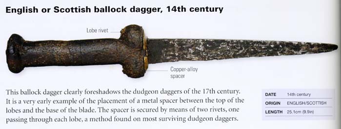

 Attachment: 36.45 KB
Dated to the 14th century, but not specifically. It doesn't say where it rests now either. Published in Dr. Capwell's recent book on daggers.

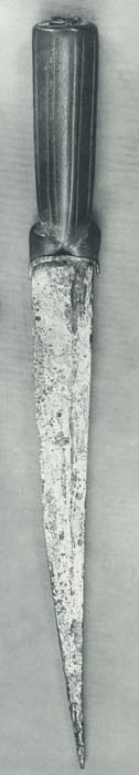

 Attachment: 16.83 KB
Dated to the late 14th century. Housed in the Museum fur Deutsche Geschichte in Berlin.

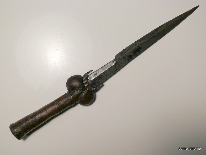

PostPosted: Fri 05 Feb, 2010 12:42 pm    Post subject:         Reply with quote

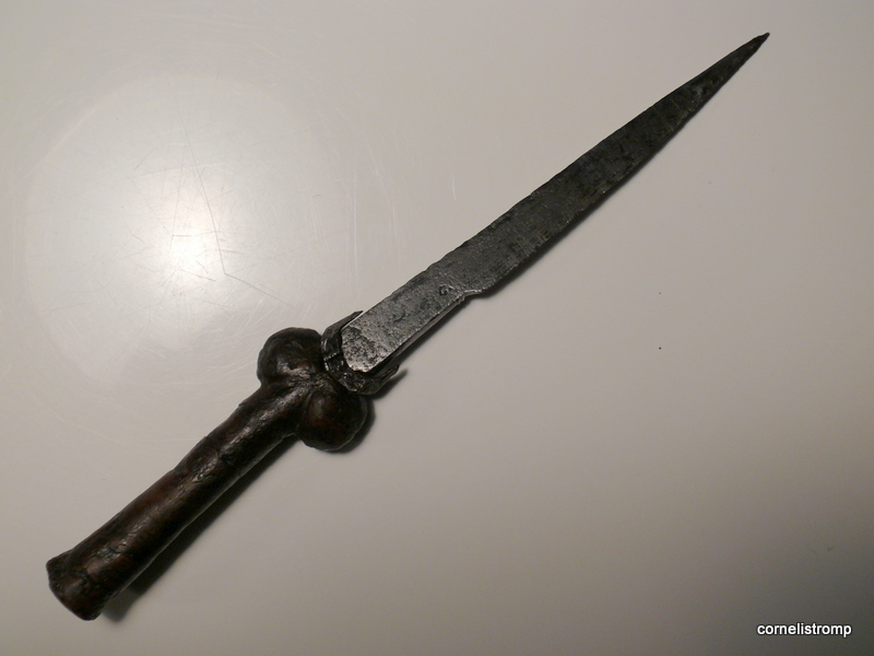

this ballock dagger has been found in Amsterdam, it can be dated 14thC.
best regards from holland
 Attachment: 161.89 KB
 Attachment: 159 KB
 Attachment: 137.01 KB
 Attachment: 128.02 KB
PostPosted: Fri 05 Feb, 2010 1:37 pm    Post subject:         Reply with quote
Cornelis,
Thanks for sharing this. How did you arrive at a 14th century date for this? It's a nice dagger, but the reinforced point, asymmetrical blade, bolster/guard, etc. all look like 15th century items to me. This would be an early example of those things.
Cornelis Tromp
Location: Holland
Joined: 03 Jan 2010
Posts: 87
PostPosted: Sat 06 Feb, 2010 1:26 pm    Post subject:         Reply with quote
Chad Arnow wrote:
Cornelis,
Hi Chad,
it is only my own interpretation so it might be wrong. (I am aware that this type is generally dated mid 15thC. fa a similar dagger in the Wallace collection)
In the 14thC the reinforced diamond point and ricasso had their introduction in sword design.(examples of typeXVIa and XVII).
this ballock dagger has a of blunt ricasso in order to be used with 1 1/2 hand and a reinforced point.
Best regards from Holland

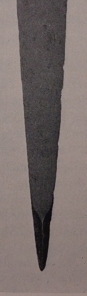

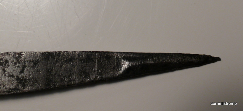

Look at the closeup of the tip on this dagger and see its reinforcing. Many believe that this makes it easier to punch through mail. This is not the case. The best shape for punching through mail is a thin spike, but this is is a fairly fragile shape. The whole point of reinforcing these kinds of weapons is to make it less likely for the tip to snap when the weapon FAILS to punch through mail (or bone). It is a compromise between practicality and armour-piercing capacity. Every design has a tradeoff. You lose a little armour-piercing capacity and gain a more sturdy weapon.

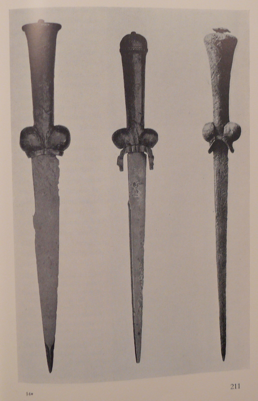

PostPosted: Mon 08 Feb, 2010 11:54 am    Post subject:         Reply with quote
herewith 3 daggers published by heribert Seitz in Blankwaffen 1. p211
the left dagger from the Metropoltian Museum of art,NY has a similar reinforced point as my dagger and is dated end of 14thC.
the dagger in the midle is dated 1450 ( also collection MMOA,NY)
the dagger on the right from the Statens museum, Stockholm Sweden is dated 15thC.
