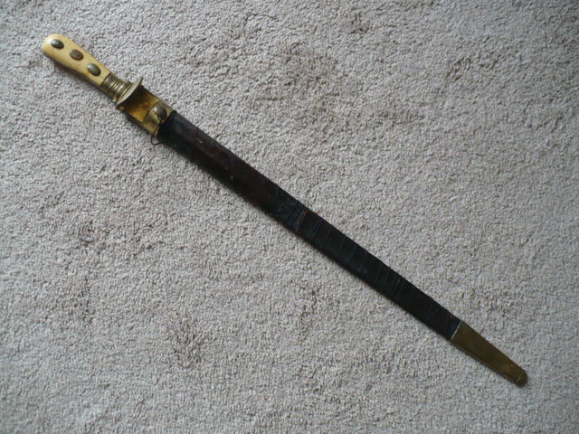

From what I have seen in the albums my sword is probably a German hunting sword. But I would like some more information if possible. It has been passed down to me and supposedly belonged to my GGGgrandfather who was born in Hesse Darmstadt and his son, Henry, immigrated to the US. I don't have dates on Henry's father but Henry was born in 1852.
The sword in 28 inches long. The grip appears to be ivory and the sheath made from leather or animal hide. It also appears that there should have been a short 5-6 inch dagger that also went in the sheath but that is missing. I saw something like that in the album on this site but I'm not sure.
The blade is single edged and their are no maker marks or symbols anywhere that I can find.
The string around the sheath is helping keep it together as my brother when we were kids found it and cracked it all up.
Thanks for any help you can provide.

Hello Greg,
I am by no means expertise of these but my feeling is it does predate Henry and an 1852 date. You may enjoy browsing this site, as I am but another simple scholar of these.
http://swordlinks.com/courtswords/intro.html
Both the blade shape and grip says late 18th century to me but as I mention, i am no expert. It also appears that the arms/quillons of the guard have broken off. If there are indications of stubs next to that shell shaped counterguard, they may have broken acidentally or removed on purpose. I do feel it middle to late 18th century but am wrong as often about right in some of my speculations.
There would indded have had a by-knife and its not unusual for there to also be other accoutrements. The accessories are often long gone to owners over the years. There is even a bit of mixing and matching amongst dealrs trying to comeup with the best value package. It is also possible to find the knves and piec4s from time to time (rare but there are a few that sell them).
A wonderful story and a nice piece. Perhaps more can better date it. I do think it earlier than mid 19th century. I am bad at my research on these, even as far as picking up a couple of more books here but I will look about a bit.

Greg, FANTASTIC.. For this sword & sheath, to not only have survived, in this Great condition , it must have been a "prized" possesion (as I am sure it is now)
BTW, if this is a "hunting sword" which IMHO, its, then a Bi-Knife would be a part of the set.
Jack

Learning the terms here but by quillon you mean the hand guard it is only one sided, no breakage.
Can somebody show me what a bi-knife would have looked like? Must have had a short handle to fit between the hand guard and the sheath.
Anybody provide any more information? I can provide additional pictures if it's helpful
Thanks Again.
Greg

Hi Greg,
quillons as in a cross or legs that would sick out. Your picture looked like a stub of an arm but it is the reflection of the guard collar that made me think there might be a stub(s).
The secondary knives vary a good bit in blade shape but normally single edged and if you think in terms of the sword knive itself, it was probably originally bone or ivory. the catalog listed above has a few examples. If I come across the particular seller I was thinking of with loose knives, I'll post it up but quite often I run across stuff doing pretty simple searching via Google. It wasn't a site I booimarked, hence a passing reference from some time ago. At the time, i was simply searcing the word hirschfanger. One might also look up the word trousse in some searching. Trousse searches are going to bring up lots of hits but probably a lot referencing items a bit different. Same idea though. Package deals of the past.
Good luck with it.
GC

PostPosted: Mon 01 Dec, 2008 1:33 am    Post subject:         Reply with quote
The model is that of early renaissance messers, it seems too well preserved to be from that age.
Moreover, the little shell at the guard was originally a real sculpure of a shell, this appears to be made in tht style but without following the real shell pattern.
I would say that it is younger but made in the traditional style.
More full size pictures would really help..
I have a lot of messers pics downloaded from the net, pls pm me if you want one[/b]

PostPosted: Mon 01 Dec, 2008 4:50 am    Post subject:         Reply with quote
Hi Bruno,
I would certainly bow to expertise on this one but the late 18th century items are quite like this. By the mid late 19th century, the stylings of Carl Eickhorn and others start to see a real progression in the matter the blades are shaped. Even moreso, we see swords of this type with the acorn finnials and cast shells.
As to condition, I see acres of premium antiques including scabbards. I would have to agree that condition is anything but condition and a poor read of when a piece was made. As to stylings, certainly timeless in manner for a great many.
GC

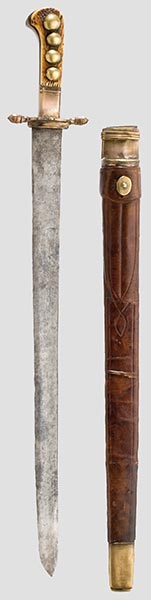

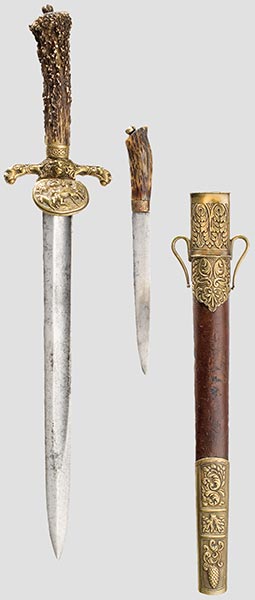

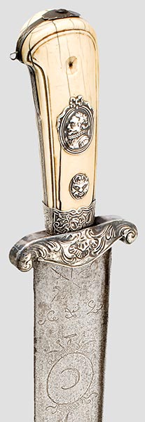

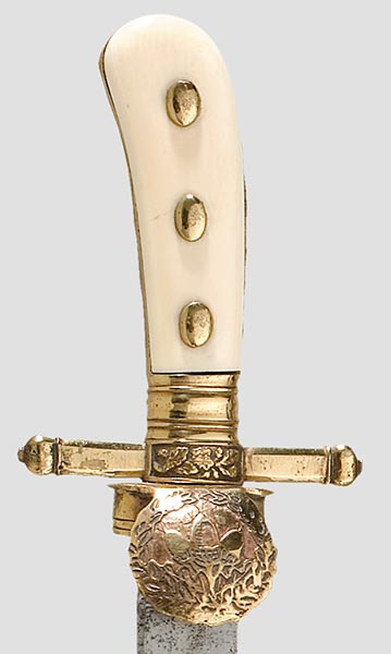

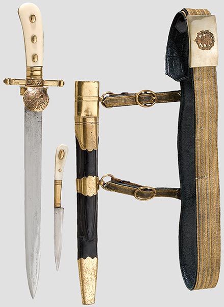

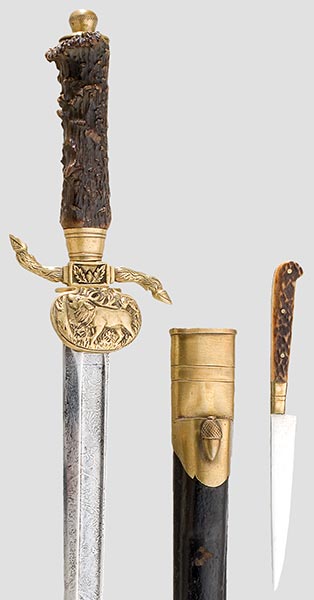

PostPosted: Mon 01 Dec, 2008 7:25 am    Post subject:         Reply with quote
Second half of the 19th c. sounds right to me. Here are a few 19th c. examples from Hermann Historica. The first is late 18th c. The last, complete with belt, is ca. 1900 and sold for 1500 Euros (note the oval rivets almost identical to yours). Note also the by-knives. Historically, much of the hilt of the by-knife is inside the sheath, and the hilt might still protrude above the mouth of the main scabbard. You can probably find a replacement byknife if you watch the Hermann Historica auctions. http://www.hermann-historica.com/

Wow that last one Sean posted looks close to the design.
