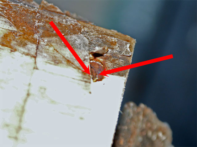

In the recent months I've come across a project that involves having custom design made by one of the China-based sword factories. The first sample was on par with Windlass sword's hardness, which was lower than the legacy Atrim swords. So we asked for higher hardness. The next sample was made with T-10 steel, similar to 1095, and its hardness beat all the swords I've handled, including high-priced custom makers production. However, the story didn't end here.
http://hk.youtube.com/watch?v=pvAaVGDF3Qo

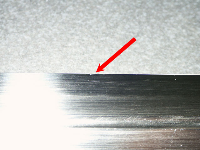

A few days ago I cut a very tough, large and thick cardboard tube with my Tinker custom sword. The blade was all scratched up and the edge needed touching up with steel rod. However, it fared the best among mine and my friend's collection. Tinker's choice of hardness vs toughness is really great. I've come to appreciate it a lot. The metal grain is super fine compare to other makers' swords. I've handled swords from various sources, including other custom maker's work, which spotted harder edge than his swords, but one of them (A Chinese-made custom Jian) cracked and lost some piece of metal when it accidentally hit a nail during a test cutting.
The jian's cutting video:
http://hk.youtube.com/watch?v=bIUU6jpKQkQ

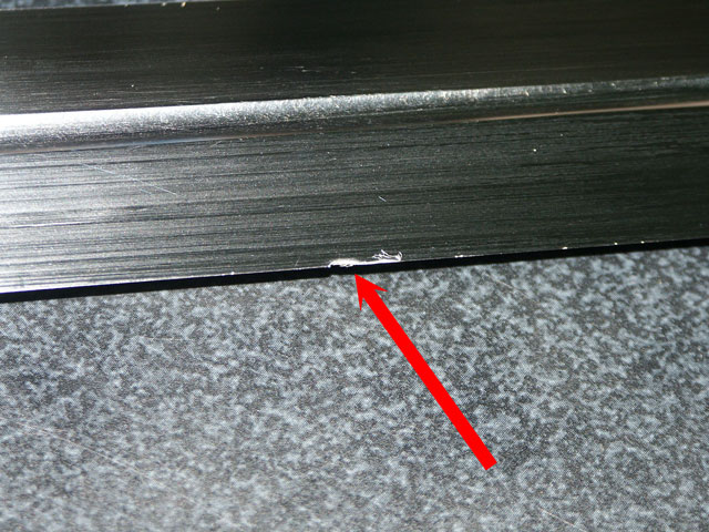

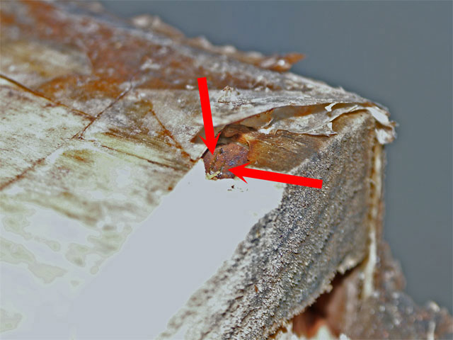

On the other hands, similar accidents had happened to my Tinker sword and Zachary's John Lundemo's sword. They simply had a mal-aligned edge afterwards and were fixed within half an hour with a steel rod, without any removal of material. Not to mention that they both cut a huge chunk of the rusted nail off!

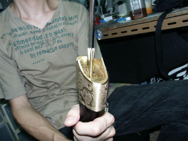

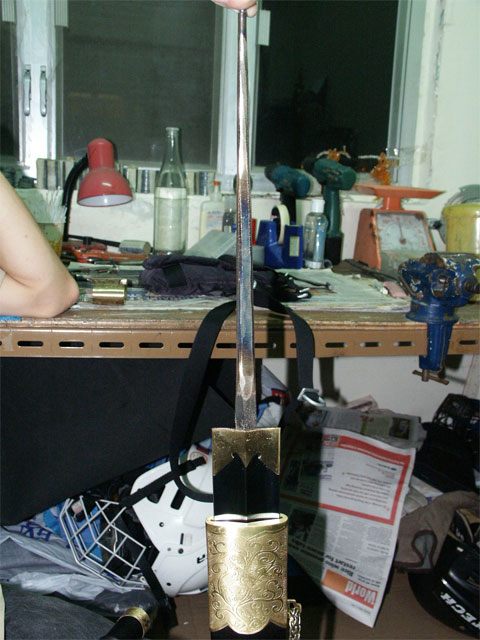

After learning that particular sword was hard but brittle, I moved on to test one of my master's custom order of a Chinese war sword that was produced by the same factory along with two friends. It was way harder than any swords I've come to handle. It could cut into a iron fence and fire-water hose without any damage to the thick bevel edge. However, when it hit slightly laterally in a diagonal cut, it broke out a huge piece flying.... Luckily I had taken cover when my friend did that. The crack extended on the sword blade in a semi-circular way and half of the cracked piece that had gone loose was shown along with the sword.
I think our highly prized custom makers are still the best. Big Grin Their stuff have been long tested by experts and proved themselves through the years. The emerging China-made swords are attractive in price, but they currently lack a user-base to help test their swords in historical-accurate usage aspects, thus often came with crappy, cost-saving internal structure.... like a circular handle slot that led to rotating handle and guard after strikes, a rat-tail tang... etc.
