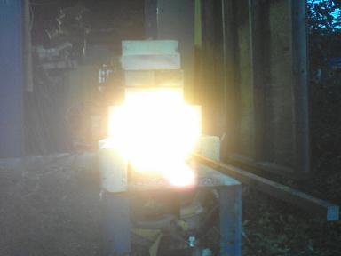

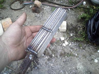

I started stacking material up for a new billet of damascus (or pattern welded steel if you prefer...). I started with a 13 ft of bandsaw blade and some sword blade stock and stacked it up. With the pieces I had I ended up with 7 layers of chromoly and 6 layers double wide of bandsaw blade, yup that makes 13 layers.
I fired up the new forge I built with Paul Dubro of Legacy Forge over last week and welded this stack up.
Twisted 13 times around with no additional stacking. Today we forged it out into a blade a little over a 1/4 inch thick with distal taper over 31"
Here is the pattern in bar form, it will change quite a bit once we cut into the pattern by grinding to create the edges. Still I really like the bold look, once we grind the broader areas of pattern should show several layers.

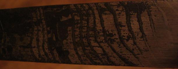

It is time for an update on this project.
I have the blade ground and polished, so I gave it a fast etch and took some pictures. This is not our final finish, but you get the idea.

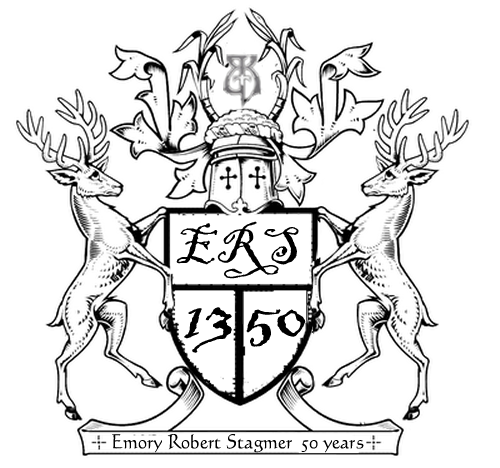

Here is the engraving that I worked up for the blade.
Made sure the deer had 13 point rack.
This will be diamond scribe egraved on the blade after etch.
