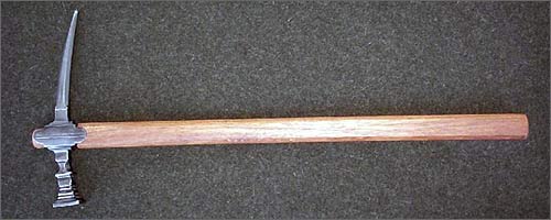

I own a couple of warhammers made by Del Tin Armi Antiche: the DT3152 and DT3163, which I managed to get ahold of before they were discontinued. The DT3152 sports a rather heavy head that packs a lot of punch, but which also makes the hammer slow on the recovery. The DT3163 is a lot lighter, and capable of dealing quick, piercing blows with the backspike. I bought the head "as-is", shaped a hickory shaft to a period-looking octagonal cross-section, and mounted the head, securing it with a steel wedge. The warhammer is of a style common during the 16th century, quite popular with knights. Original warhammers usually sport a belt-hook on the side of the head, which enabled the wielder to carry the hammer with him while using another weapon. This hammerhead is cast in tool steel, with no casting flaws, cracks, or notable pitting.
Click to enlarge
The DT3163 Warhammer

Weight:1.875 pounds (850 grams)
Overall length:23.7" (602mm)
Length of head:9.685" (246mm)
Length of backspike:5.6" (142mm)
Striking area (hammer):1.339" (34mm) square
