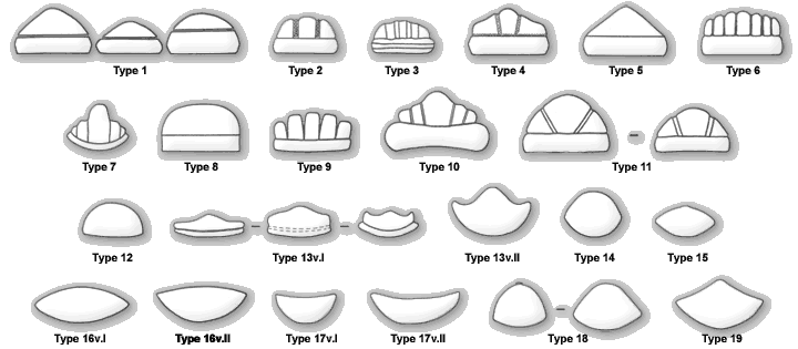

Pommel Forms
The pommel types referenced below are accompanied by illustrations, and in them those familiar with Petersen's Viking hilt Typology and/or Oakeshott's simplification of it, will find much that is familiar. Geibig's Type 6 can be recognized as a form of Petersen's Type K for example, just as Type 9 corresponds to Type O. The later pommel types, all variants of Petersen's Type X, can be found within Oakeshott's pommel types of 1100-1325 as detailed in The Archaeology of Weapons. Variants of Geibig's Type 13 cover Oakeshott's Type C and Type D. Type 17 bears a resemblance to Type N. Type 19 follows Type E, and so forth. Some differences will, of course, be apparent. Geibig's Types 2, 3 and 4 do not easily fit into Oakeshott's typology. Type 2 and Type 3 may be Mannheim variants according to Petersen, but Type 4 seems lost amongst his "distinctive types." These variations in emphasis and distinguishing characteristics are only to be expected.
