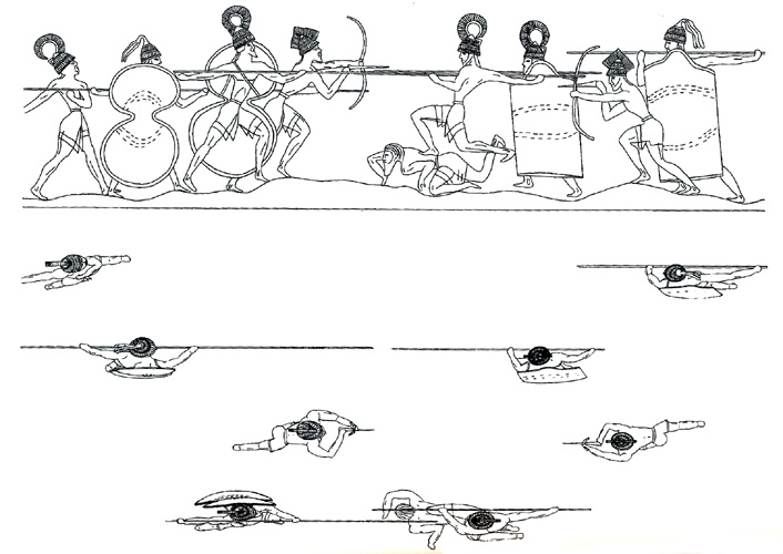

Hi folks,
I'm making a Mycenaean figure-8 shield. Pics after a while.

We don't really know much about them. We know what they looked like from illustrations but that is about all. We only think that they were made from hide because some of the illustrations show a pattern that resembles the fur on cowhide. The Lion Hunt dagger shows the shield's back, which has a neck strap, not a central hand-grip (the shields were used with two-handed pikes). One illustration shows cross-hatching, which suggests that the construction might have involved wicker but that is on the later Dipylon shield, not the Figure-8 shield. The vertical keel on the facing tells me that a wicker backing was not needed. Looking forward to seeing what you come up with, Todd.

I think there is a lot of room to use bentwood and wicker skills to understand ancient shields. Most people come to shieldmaking from woodworking, metalwork, or leatherwork. Most traditional shields are based on a form you can easily make, whether spreading a skin over a frame or splitting one whole width off a tree with wedges, but we rarely have those intuitions because are are not weavers and woodbenders and butchers and because the fancy metal copies of the cheap wicker-and-hide shields survive better.
One thing I noticed when cutting the hides for the shield is how much the weight adds up quickly! One thinks of rawhide as light, but in large body protecting surfaces, it adds up very quickly. I was initially going to use to two full thicknesses of hide, but that was already too heavy, even without the mast. in depictions where warriors are using two-handed spears the shield is held by a guige; anything too heavy would bruise or injure the warrior using it that way.
Iirc, Homer mentions shields skillfully made of many hides sewn together, but no mention of wicker or weaving wood together; certainly that would have been mentioned? I think either Homer was accurately describing the sewing together of many bovine hides (seven?), for a shield made from the smaller cows of times gone by, or was exaggerating things, like the tales of Paul Bunyan; is it from Peter Connolly? I'd want more hide layers instead of wicker. I think a lot of folks who haven't worked with hair-on-cowhide are unaware of how tough and strong it can be. Rolling an edge of rawhide over a strip of rawhide can create a many-layered rim that is very tough, and being bent backward and supported by the mast, would be an extremely anticlastic construction. Looking at the Pylos Agate, you can see the middle of the shield pulled back at the sides. Everything nis curved in at least two directions. ("Anticlastic" is a word I got from the great Jeffrey Hildebrandt).
Iirc, there are mentions of hide shields in military texts from Nuzi. I think the Minoan depictions are showing the shields from the back, not front, in a stylized manner; no sculptural depictions show wood on the outside. and no wicker on the inside. I know there are some depictions with crosshatchings, etc. But those are ambiguous. I think there is a depiction where you can see the texture of the back of the hide where the flesh was scraped off.
Looking at Egyptian shields, I think the curved ones were usually all-hide; you wouldn't need a metal boss if they were solid wood; Tut'[s "shields" don't have bosses.
So, what if I am wrong about the figure-8 shield? Not to worry! I can always add slats to the back of the lobe areas if I need to. If I had to, I'd add an "x" shape behind each lobe. Like the pieces mentioned by Homer for round shields; those two pieces also wouldn't provide a tremendous amount of support for a round hide shield that was quite large, i.e. "ankle tapping".
It dawned on me that I'm going to have to focus on this shield over the Egyptian one, so I can avail myself of the hot remaining days to dry the shield after it is wet.

Agree to most of that! I've looked at other hide shields. I've interpreted the border on the figure-8 shield depictions as an edging, which I will add to the shield after it dries. It will be much easier to have the roll on the outside and it will also dry better and create a more anticlastic form. It really seems to be on the outside with the Pylos agate depiction.
Here is the plan, which you have mostly figured out:
1. Finish the mast! You will notice it curves at each end are the same distance as the radius of each lobe, so that when the hide dries and contracts a bit it will have the same angle (mostly).
2. The mast will be lashed to the inner layer of the shield with rawhide lace after the layer has been wet and then dried to "leather hard". At this point I will also chisel the curved rows of slits for the lacing which passes through both layers and arches across the middle top and bottom of surface of shield. I will also drill holes along the edge to match holes on the outer layer.
3. Drill holes along perimeter of outer hide layer. Get the layer wet and dry to almost leather hard. place the inner layer and mast in place. weave through the .5" leather hard rawhide laces to bind the inner and outer layers together. Lash the mast, too, where the laces cross it.
4. Lash the very heavy rawhide lacing all around the shield's outside edge and the edge of the inner layer. roll the edge over the lace, starting from the top of each lobe, working to the middle waist of the shield, on each side. Roll it about three times and then drill a series of holes along the edge and lash the roll all along the edge of the shield.
5. Pull the middle (waist) of the shield back, a la Pylos Agate, and use the .5' lace to hold it to a form while it dries. It will pull the edges back as the shield dries and contracts. Test showed the rawhide dries slightly dished, but no "bubbling" or deformation and that is good. The lobes will tilt back slightly and curve back at the edges, giving a perfect anticlastic form. I may need to use some small sandbags to keep things dished out if some problem occurs, but they shouldn't.
When things are dry, I'll attach an edging, using the same holes for the final lashing..
The Iliad describes two shields having four layers of hide. Aias' shield has seven layers but that is singled out as being exceptionally heavy, so four layers would be more typical IMO. He also says that the shields are thinner around the rim and thickest in the centre so you'd be stacking a smaller piece on top of a larger one, getting progressively smaller, which would keep the weight down to something that is more manageable. Only the bottom-most layer would be the full size of the shield (or the opposite with the largest piece being the outer layer and the smallest piece being the inner layer). He describes some shields with the layers sewn together and at least one that was stapled (it is possible that the staples were for attaching the rim around the perimeter rather than fixing the hide layers together).
If you have my book, there is an appendix covering this in detail. There are no third-party translations to mess up the reconstruction, I went back to the Greek.

Hi Dan! You bet I have your book; it?s a great resource. Then everything is somewhat on track! I?m using the inner layer, thinking that those two rows of stitches seen on the fronts is helping to hold them together. Also, I?m going to braid the end of this together and put a simple leather strap between, in addition to it having a guige. So it?s technically not an affixed handle, but grips.
It?s possible the bovine hides were smaller and thinner, so perhaps more layers had to be used. The hide I got was enormous, I think almost seven feet tall. My eyes popped out of my head when it arrived; Cyclopean. Four layers of this hide, even if diminishing size would be difficult to even lift, and you?d choke yourself dancing around with a two-handed spear.
I?m having some kind of problem with my small old phone, so excuse the typos.
Just conjecture, but I?d expect to see more visible surface lacing if more hides were used.
Aias? shield with the hides I have would be unusable unless the hides were smaller., or Homer was exaggerating. But you don?t see evidence of cut up hides being pieced together to make the surface. There is only one example I can think of that shows bilateral asymmetry in the hide pattern, and that could just be the artist doing it. Egyptian shields seem to sometimes show pieces of smaller hides stitched together.

Can we be sure Homer is describing figure-8 shields? A round shield could be made of more layers of hide Aias? shield was also said to have a layer of bronze. Have your book handy! I can?t imagine how heavy that would be; we?re talking tank tread material. Revised chronology aside (I think it is an amalgamation of old and new material), many Homeric shields were apparently round, or large and tower-like.
I think we can trust Homer a bit, but even he says Odysseus? boar tusk helmet was from an older age.

Figure-8 shields fell out of use a couple of centuries before the time of the Trojan War. Every shield that is described in the Iliad is circular, including the neck-to-knee ones. I brought up the Iliad here because it is one of the few sources that tell us construction methods for Bronze Age Greek hide shields.

I used veg tanned goat leather to edge the shield, and a mix of tallow and beeswax is applied to it. Next I?ll soak willow and add two crossbars across the keel at both lobes and lashed to it, add a guige and done.

Shield is done. I spent a hour or so walking around and trying to move fast, using a broom as a spear and it became pretty apparent to me how these were used. The guige is like the strap of a purse (my strap is made from veg tanned boar leather). The strap allows the shield to be suspended over the right shoulder, and this allows the right shoulder and turning of the torso to instantly control the amount coverage of the body, while one is still able to use the two-handed spear. So a line of troops with these shields would move forward with archers hiding behind them and when there are incoming projectiles the troops with the shields go to full cover while still moving forward. It?s interesting the are so many reverse-Achilles scenes where the spearman with the shield is being killed by some acrobatic shock troop armed with a rapier that is able to close the distance and avoid the spear.
Materials:
Hides, willow wood, linen, hemp, goat and boar leather.
https://imgur.com/a/6omGN1c
The cross braces are willow.
https://imgur.com/a/xwx0a7O

Dan D'Silva wrote:
Hi Todd. Looks good overall. I'd like to ask what you think of the feasibility of making the sides pinched as on the votive shield from Mycenae rather than cutting to shape.
Hi Dan! Well I just lost a long post. So I will get to the point! I think the Pylos Agate depiction and some others represent different kinds of shields!!! Cool
I think most of them were made from one large hide. And there were curving round shields that were impressed with the lobes to add strength, as they dried. These could have later turned into the round bronze Homeric shields, while the figure-8 shields become the Dipylon shields. Imagine if the waisted area on figure -8 shields stretch back a foot in the depiction below from Salimbeti?s site. Or the acrobatic pose on the lion hunt dagger.
