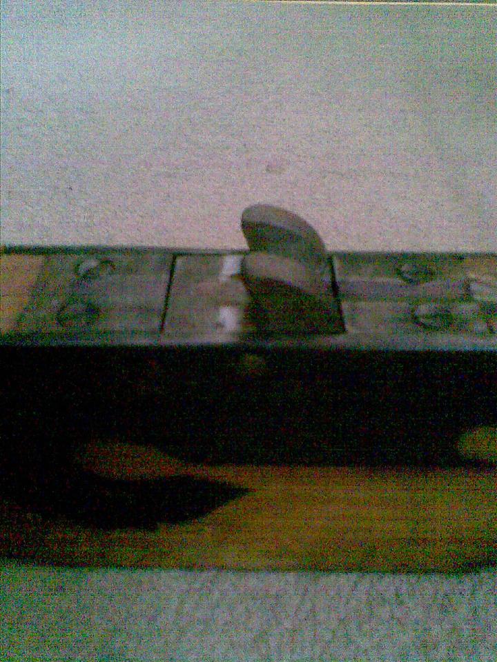

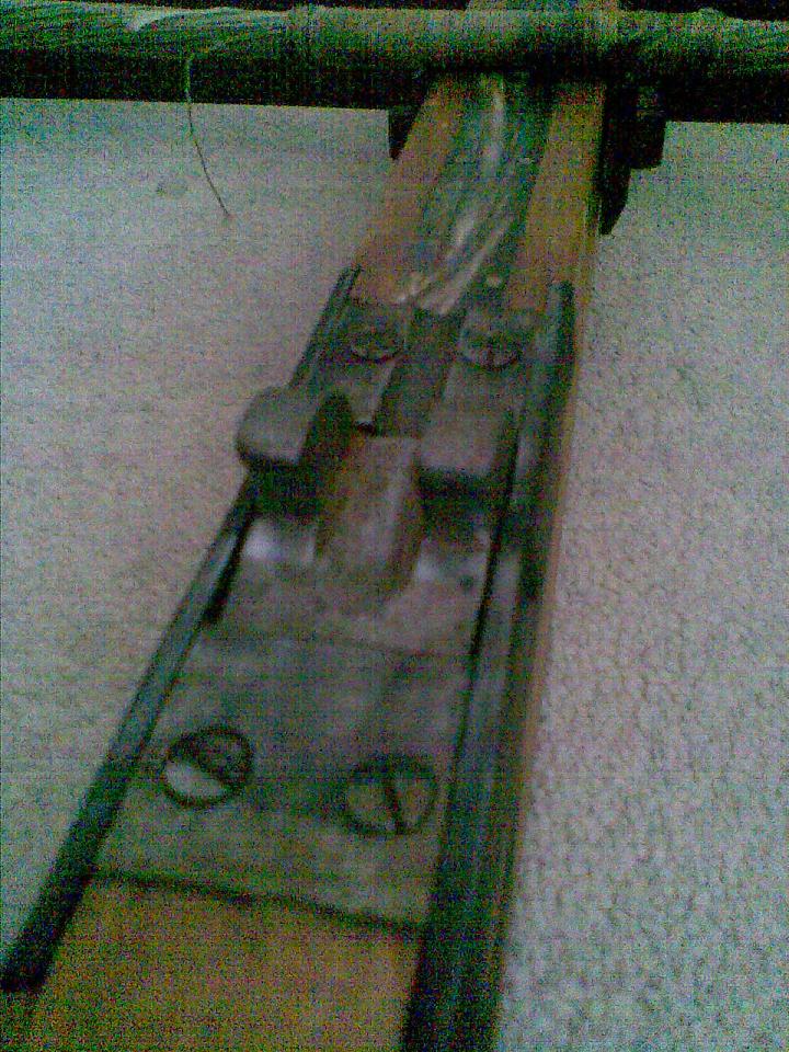

PostPosted: Fri 14 Sep, 2012 6:50 am    Post subject: Bolt weight         Reply with quote
Hi All,
I recently bought a windlass crossbow approx. draw weight 1000lbs though this has yet to be confirmed but the bolts available to test it were obviously far too light and basically were thrown/ flipped off the end of the front of the bow no more than 12 ft or so. Unfortunately the windlass strings then parted.
Having renewed the windlass and made more appropriate bolts 1 1/3 oz and having read the entirety of this thread I now suspect that even these will be too light to operate properly - and indeed they were tossed of the front of the bow much like the lighter bolts - you can see the bruise on the bolt just forward of the flights where the string has made a second contact with the bolt rather than shooting it straight.
As there are a few makers on this forum, can this be a result just of insufficient bolt weight or is there a mechanical problem with the string leaving the nut?
My next intention was to recreate the bolts that PG found to be optimum but even these may be too light. Comments please Happy

PostPosted: Fri 14 Sep, 2012 8:48 am    Post subject:         Reply with quote
The bolt weight will not cause this. the string is slipping over the bolt.
A larger diameter may help. Otherwise talk to the maker.d

PostPosted: Fri 14 Sep, 2012 8:54 am    Post subject:         Reply with quote
from observation it would appear to be going under the bolt - i will try and film it next w/e to see for sure

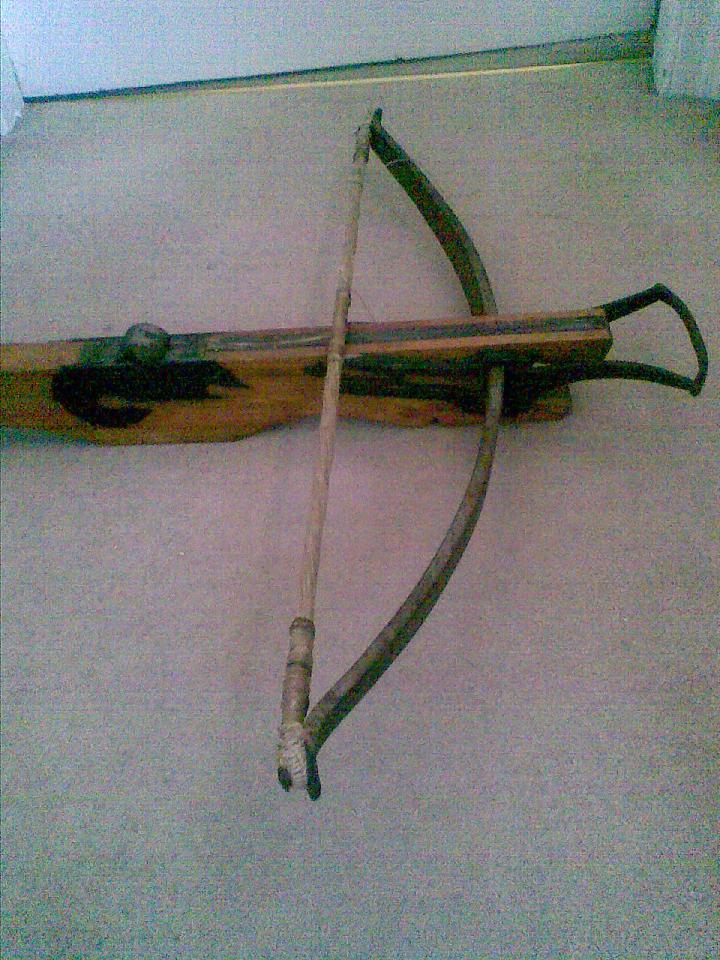

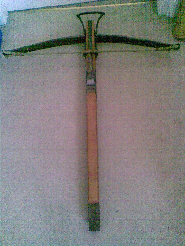

PostPosted: Sat 15 Sep, 2012 12:23 pm    Post subject:         Reply with quote
Hi Gareth,
That sounds curious.
Out of interest, could you let me know the bow dimensions at the centre and near the tips and the length of the bow?
A picture would be great also.

Gareth Prior
Location: Staffordshire Moorlands
Joined: 26 Oct 2011
Posts: 7
PostPosted: Tue 18 Sep, 2012 11:10 pm    Post subject: Dimensions         Reply with quote
Length 35" width 1 1/2" depth at nut 3 1/4" string 30" braced at 6"
Pics attached sorry the quality isn't brill taken using phone
