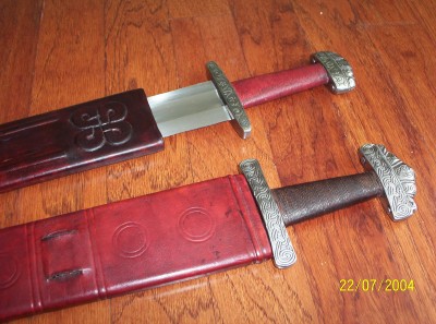

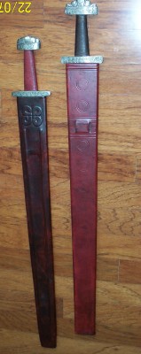

Here are Couple of pics of 2 rough and ready scabbards I recently put together.
 Attachment: 59.06 KB
 Attachment: 28.78 KB

Very good James but how did you do the designs on the top?

Nice work, more ready than rough me thinks looking at the pics,chap,
are the leather designs stamped,or is it raised work under the leather,
Hmm, same Q as Lee,

Thanks Lee and Lee , The "pretzel" motif is moulded under the leather using AB epoxy sculpt. The circles are pressed into the leather(sockets).

Thanks Man, the tips you gave me at the Bladeshow realy helped,(esp. Seigals leather).I REALY appreciate what real scabbard makers do now more than ever.Every step, from hollowing out the wooded core to dying the leather was a Bee...otch. Oddly both scabbards were dyed Mahogany...one in an air conditioned room, the other outdoors in 90 degree heat (humid).???

Thanks Robert, Seigals offers 3 0z leather at very reasonable prices,plus supplies.

The Knot design is common in Scandinavian art (and is simple) the outer lobes of the pommel on the "Vinland" are decorated with circles (the dash-dot motif was very common during the period, and it was very simple). The shape of the scabbards....well the "clontarf" scabbard started off with a pointed profile to match the blade, but after cutting the leather too short, I clipped the end .I like the look of some of Patrick Barta's viking sword scabbards with the square ends, and since I can't do chapes so I went with it.
