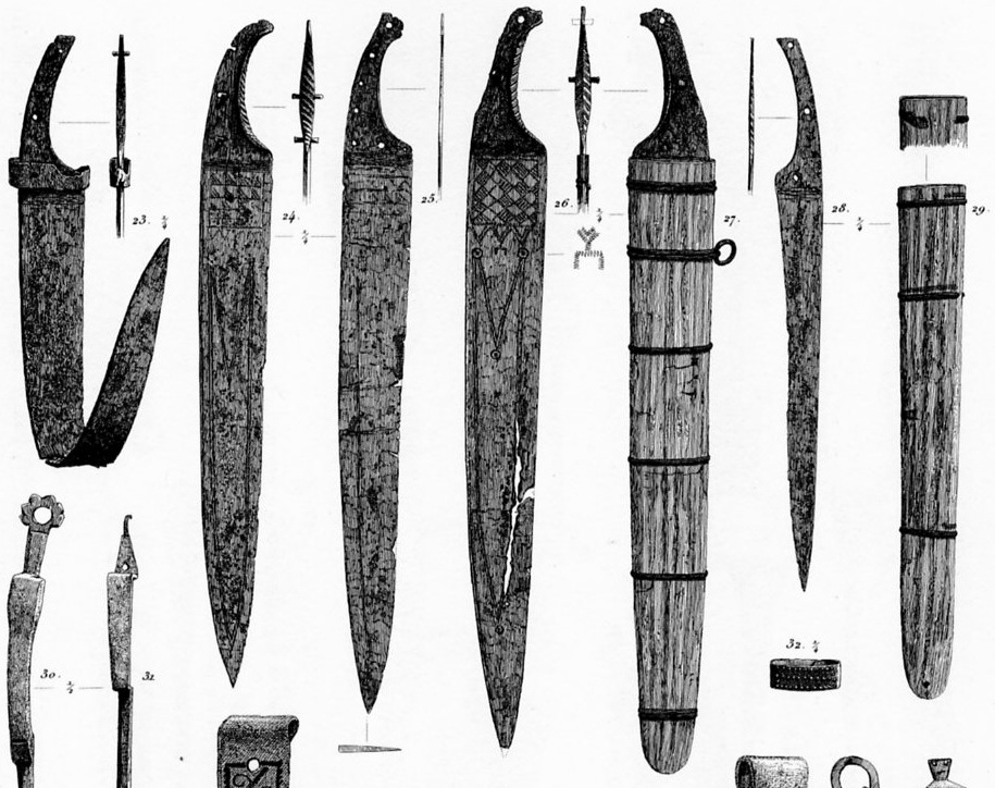

Sorry for my really late answer, i simply lost track of the thread.
Why they imported blades in the first place can only be explained, because those imported blades must have had a good name simply because of their origin. Like we today think of quality steel when we hear names like Solingen or Toledo.
Their technique may have been different, but they were undoubtedly able to produce their own. Swords as such were known since the bronze age, so the general idea wasn't new.
Below i included a picture of "seaxes" from Vimose at least seax like swords.
It's taken from Conrad Engelhardts "Kragehul og Vimosefundene" from 1869.
Sadly i must admit i am not quite sure anymore from which phase of the Vimose find they are. Maby from around 150 A.D., but i will have to look it up again.
Regards
Arne
Attachment: 206.65 KB
