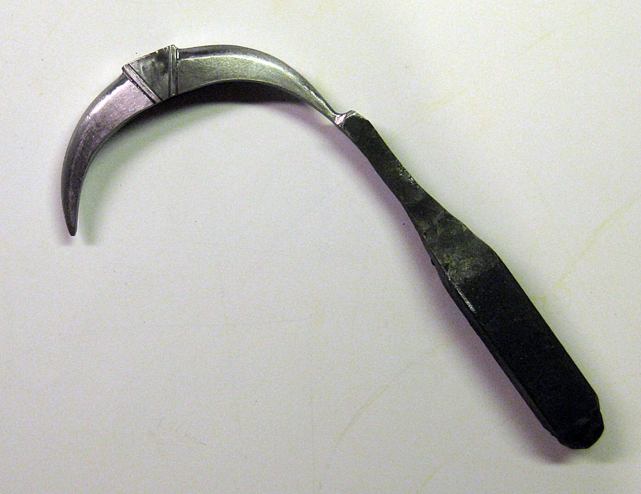

Picking it up again, I have decided on what type of scabbard to make for this cinquedea - I'm going to go with a scabbard from Armi Bianchi Italiane that has 2 by-knives, see below at bottom. The scabbard will not have the metal band at the top, which apparently is a modern addition.
I have prepared the inner layer of the scabbard and am now working on the by-knives. The pick is done, started cutting and grinding the shape of the knife . For these I'm repurposing one of a few sets of cheap and very large knife and pick I bought years ago, see the before-after pics and how they are going to be placed on the scabbard.
