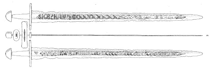

Looks almost like a cousin of this one in the Drenthe Provincial Museum in Assen (Inv.Nr. H 1923-270)
OAL: 102,2 cm; Blade Length: 88,8 cm; Hilt: 13,4 cm; Grip: 9,3 cm.
Pommel: maximal 3,05 x 5,8 x 3,4 cm.
Cross: maximal 0,9/0,7 x 15,0 x 2,5/3,0 cm.
Blade: largest width ± 6,4 cm largest thickness 0,55 cm.
Fuller: width: ± 2,6 cm; depth: 0,1 cm.
