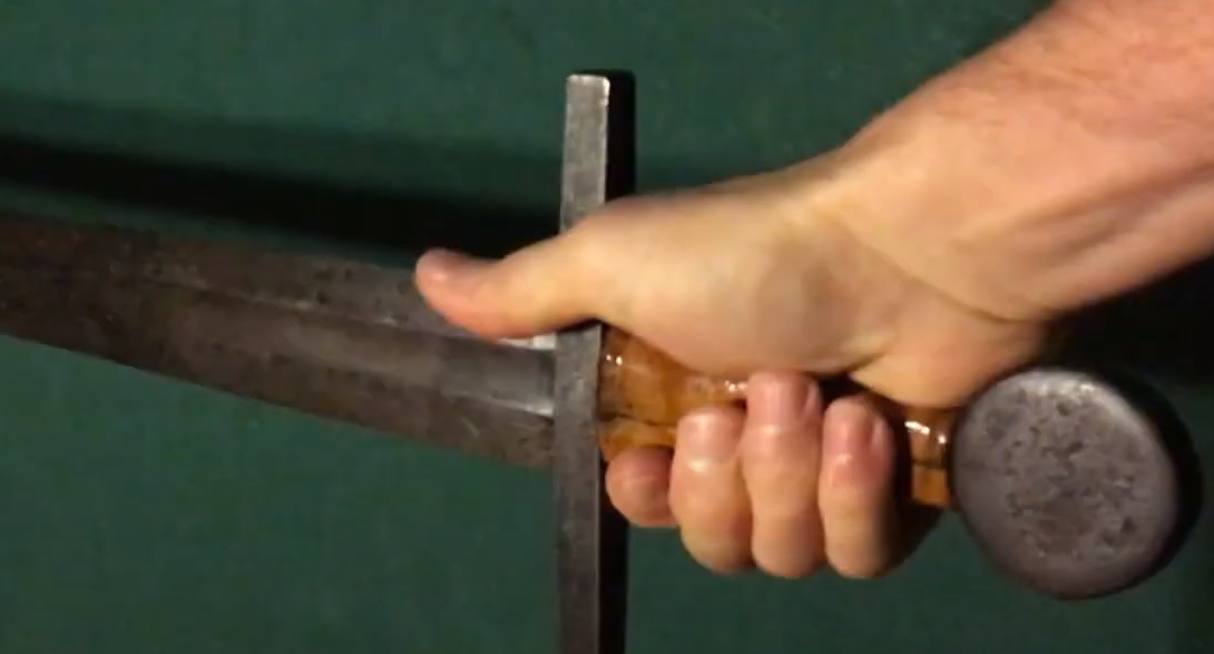

At least that sword Oakeshott used to own has a very bulky crossguard. While thinner ones are generally more common, this is by no means an ahistoric shape in neither width nor height
https://www.youtube.com/watch?v=poJ5rUkuRKY&ab_channel=JohnClements
 Attachment: 442.26 KB
For more angles, watch the linked video [ Download ]
