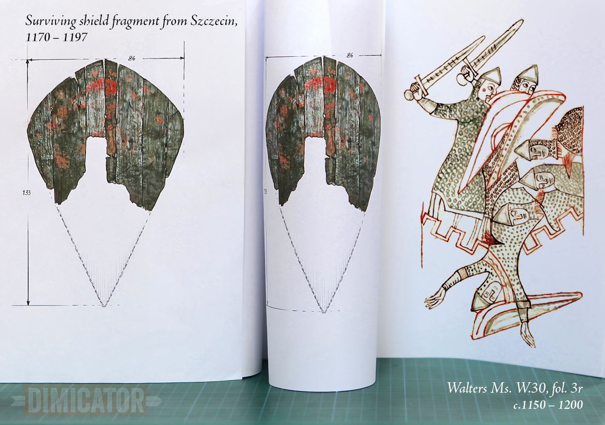

Martin Kallander
Location: Sweden
Joined: 25 Sep 2018
Posts: 127
PostPosted: Fri 07 Aug, 2020 7:22 am    Post subject:         Reply with quote
At first I was honestly a bit bummed when you linked to the shields as they didn't really look like kite shields conventionally do. Having seen what they would have been like if curved however, I am once again excited about these shields and my guess would definitely be that they were originally curved. Looking through the web I found a certain Dimicator who illustrated what the shield would have looked like if curved and it appears quite similar to how they are shown in contemporary art.
 Attachment: 262.6 KB
Dimicator's image showing how it would look if curved [ Download ]
Jeremy V. Krause
Location: Buffalo, NY.
Joined: 20 Oct 2003
Posts: 1,717
PostPosted: Fri 07 Aug, 2020 9:30 am    Post subject:         Reply with quote
Yes, I agree with the depiction- that the shield would have been originally curved.
