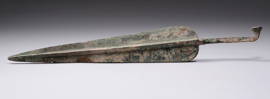

[img]Hi, everyone, I am new on here.
I am collector of Cypriot antiquities, mostly from the Bronze Age, but continuing into the Geometric and Archaic periods. I have also been studying the Archaeology and history fairly intensively.
I am giving my collection back to a museum in Cyprus gradually (it was almost all probably looted from tombs originally so there is a sort of justice there). I am currently occupied writing a catalogue, with the help of a young Cypriot archaeologist
I have two large spearheads, one from the Early Bronze Age (Philia period up to Early Cypriot II, 2500 - 2100 BC) and the other from the End of the Late Bronze Age (Late Cypriot III 1200-1050 BC)
The older one (38cm long) has a hooked tang with a button on the end. I have heard that it is believed that a hooked tang was inserted into the haft by splitting the end of the haft, inserting the tang into a groove in the wood and then binding the join. However my archaeologist will not allow me to print this unless I can find some authority for it (experimental archaeology is fine). Does anyone know a book or paper I might look at or a person who might help me?
Since before about 1600BC we have no evidence for(or against) shields it is unclear if it would have been used two handed or one handed.
Thanks
David[/img]

Matthew Amt
Location: Laurel, MD, USA
Joined: 17 Sep 2003
Posts: 1,464
PostPosted: Mon 25 May, 2020 2:49 pm    Post subject:         Reply with quote
Hello and welcome!
Yes, that's the interpretation that I've always heard. In fact, I've never heard anyone suggest otherwise, and there really doesn't seem to be another viable option, so I'm a little curious that your archeologist would object to stating the obvious. Be that as it may, I found a nice page in Yigael Yadin's "The Art of Warfare in Biblical Lands", 1963, vol. I, page 157. Hopefully that's a good enough photo! You'll need something better for publication but it should do for just a citation.

Dan Howard
Joined: 08 Dec 2004
Posts: 3,665
PostPosted: Mon 25 May, 2020 5:12 pm    Post subject:         Reply with quote
IMO the button was created after the head was inserted into the shaft. The bent tang was initially pointed and protruded out of the side of the shaft. It was then hammered flat, like a rivet, to help secure it. It might have been done to obviate the need for binding. It also serves as a gauge that tells us the radius of the shaft at that end.
This is what I would write: "Modern experiments suggest that the spear was created by inserting the hooked tang into the shaft by splitting the end of the haft, inserting the tang into a groove in the wood and then binding and/or gluing the join. The 'button' examples involve an extra step: instead of binding the shaft (or in addition to it), the point of the tang was hammered flat against the shaft, like a rivet, to provide a fastening point. Based on the distance between the tang and the 'button', the thickness of the shaft at that end was approximately xxx mm."
Illustrations of the earliest shields in the Aegean suggest that they did not have a hand grip. They seem to have been wielded by means of the shield strap over the shoulder to enable two-handed use of the spear. So it doesn't matter whether they had a shield or not, the spear would have been two-handed.
I cover a lot of this in my book. It is fully cited so should be sufficient for your archaeologist friend.
