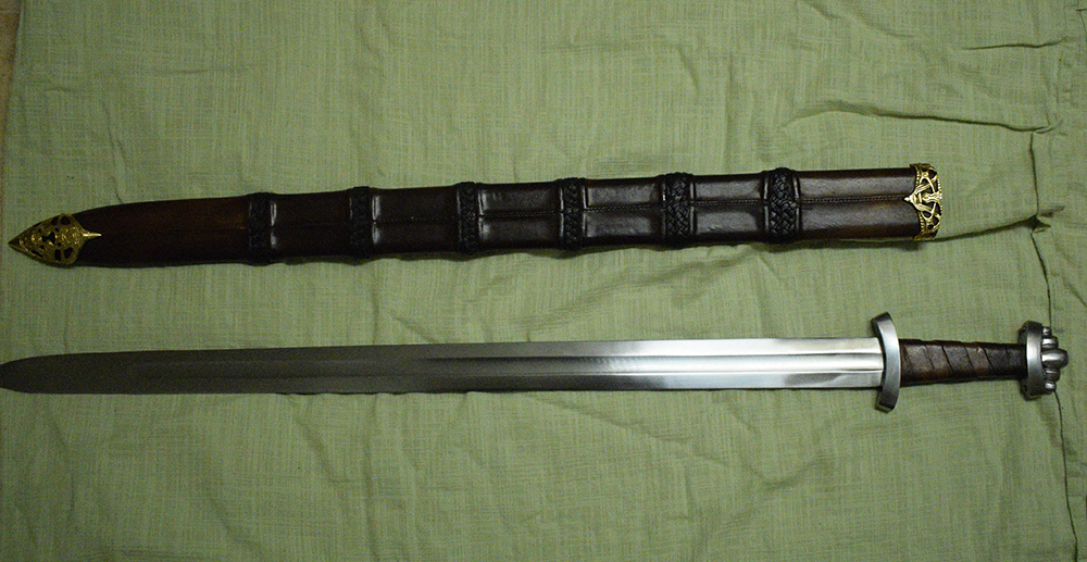

What do you think about shorten this viking sword it¨s 98cm
I want it 75cm 78cm
But what to do with the blodgrove?
Any one know seller short viking svord? around 200$
Attachment: 643.07 KB

It is my first sword didn't realize they was so long.
Any suggestion?

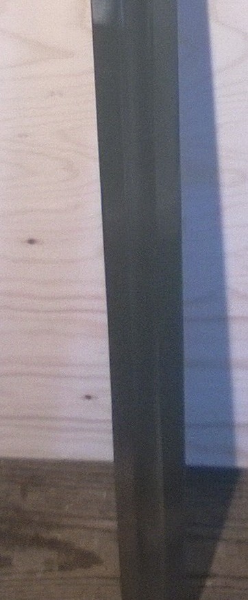

Posted: Thu 06 Sep, 2018 6:54 am Post subject: |
Hi what do you Think i fint want to thin out the fuller it is get to tin dangerus
Vant post the image
Attachment: 102.93 KB
Attachment: 140.83 KB

Yes, we thrust in reenactment, although it might depend on the rules of the local group. Are you a member of a group or do you plan to join one? Different groups may have variations on their rules. But generally a 2mm edge with a point rounded like a coin is considered safe.

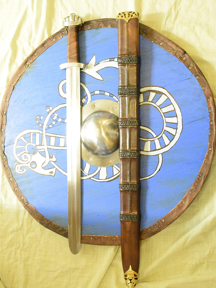

Posted: Sun 16 Sep, 2018 7:23 am Post subject: |
It got perfect not so clumpsy anymore it feels perfect
Attachment: 818.91 KB

| Baard H wrote: | | If it was too heavy, grinding off excess weight without taking down the length would have been better, although it would require a lot of skill and/or luck to not screw it up. | no think its get to dangerous thin it don't get safe two mm if the fuller is gone
