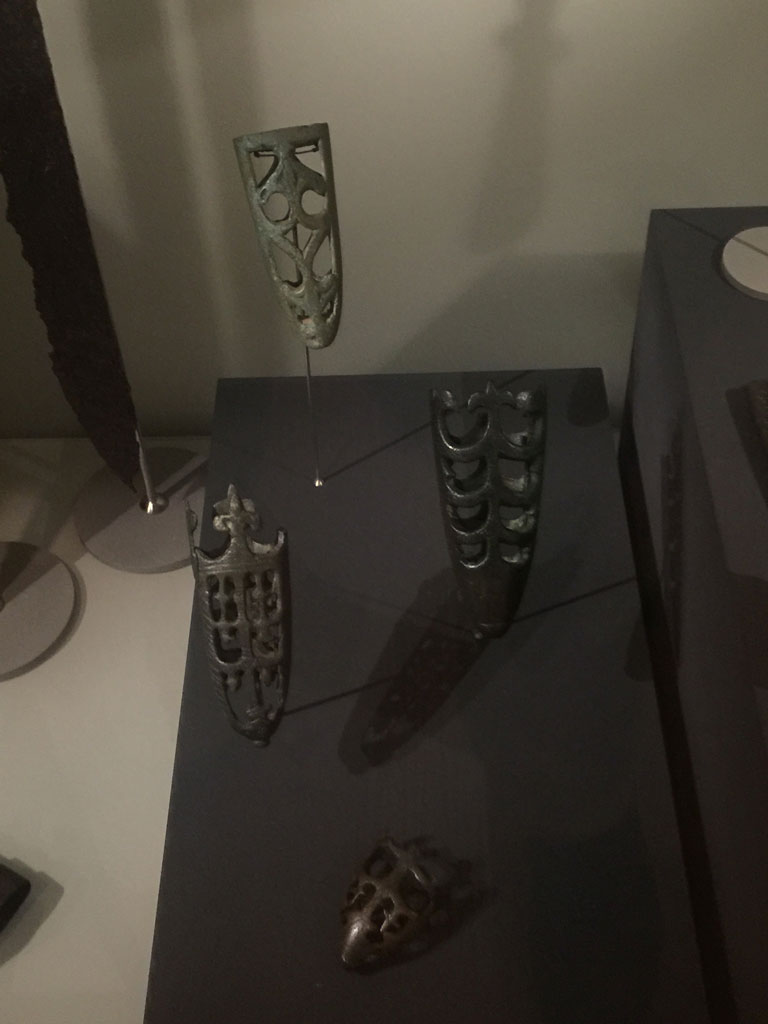

I have seen a few well preserved scabbards from 13/14th and 15th century that were lined with what looked like wool cloth.
I have not seen fleece. Some scabbards I have seen have been "naked" inside.
-*But*: I have not taken these scabbards apart. This is based on just from what you can make out from peeking inside.
