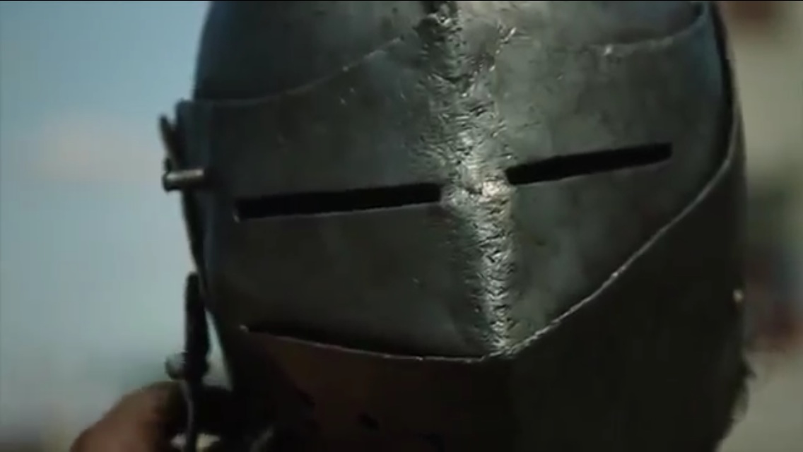

Hello everyone, I am very interested in the 16th century knightly harness, especially the close helms. I was wondering if these were ever used by dismounted knights or other heavily armored soldiers and if so what they would look like. I would like to put together a 16th century harness intended for foot combat (SCA) some time in the future and I would like to know some options for helmets. The close helm is my favorite style of helmet looks-wise but I believe it was primarily used for mounted combat.
Can anyone help me find a style of 16th century close helm more optimized for foot combat? Does such a thing exist?
Thanks
 Attachment: 123.22 KB
 Attachment: 81.87 KB
 Attachment: 13.7 KB
 Attachment: 137.74 KB
Maybe something like this? [ Download ]
 Attachment: 75.74 KB
Or maybe this? [ Download ]

Well, unless I'm mistaken, the close helm was used in the 16th century as part of armours for tournaments on foot as well as for mounted combat. I've several photos of close helmets and their respective suits from 1540-1610. Some are definitely for use on foot. For foot combat in tournaments, heavier additional plates were often fitted to one side of the armour and the armour was only half length as the combat was fought at a waist-high barrier.
Another thing to consider is that important people often had garnitures of armour which several different options for field and tournament. Cavalrymen often wore open-faced (with optional falling-buff) burgonets in the mid-late 16th century instead of close helms. Diagrams of these garnitures, for example one by Michel Witz the Younger (1560), shows that the close helm was used on foot and for tournaments, while the burgonet was used on horse in the battle. Of course, for non-knightly soldiers, morions and other helmets were common on foot.
Here's an album of mainly 16th century harnesses with close helms, dating from 1540-1610. 1500-1540 they wore armets, which are admittedly quite similar. When in the 16th are you most interested in? Imgur album, 1540-1610

The first photo you posted (one of 12 matching armours ordered by Christian I of Saxony from Anton Peffenhauser, 1590) was of an armour specifically designed for fighting on foot over the barrier, which is probably as good a 16th C analog as you will find for your purpose.

there is a good hundred and more years between that early woodcut and the civil war cuirassier, a lot happens to armour in between. If I had to chose the best to fight in then the Peffenhauser, or its Greenwich equivalent, would be the epitome for the noblemas foot armour. For the more soldierly then Martin Bavin has one on on ebay here
