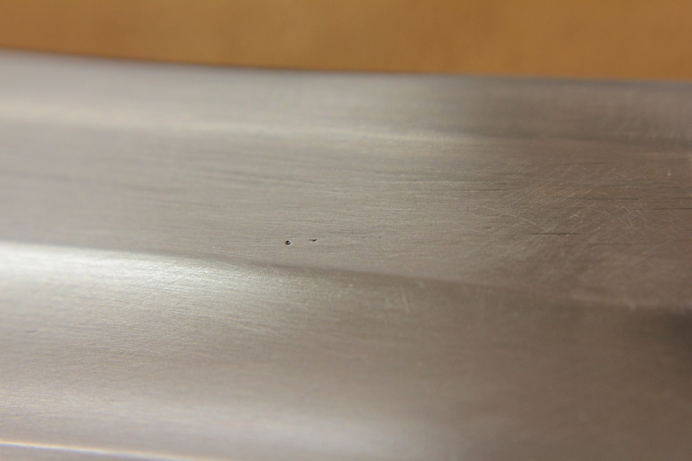

I have more pictures and videos, as requested.
Various perspectives of the sword itself.

Attachment: 115.8 KB
Marks on Blade [ Download ]
Attachment: 125.1 KB
More Marks on Blade [ Download ]

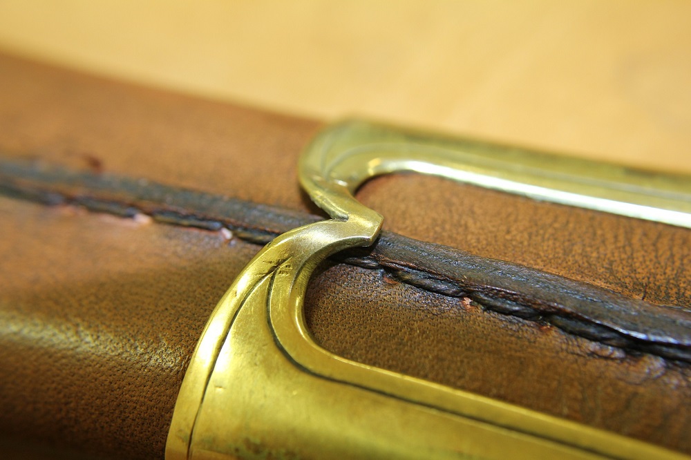

Pictures of the scabbard and belting
Attachment: 226.22 KB
belting [ Download ]

Attachment: 175.02 KB
reinforcing "bone" on belt [ Download ]
