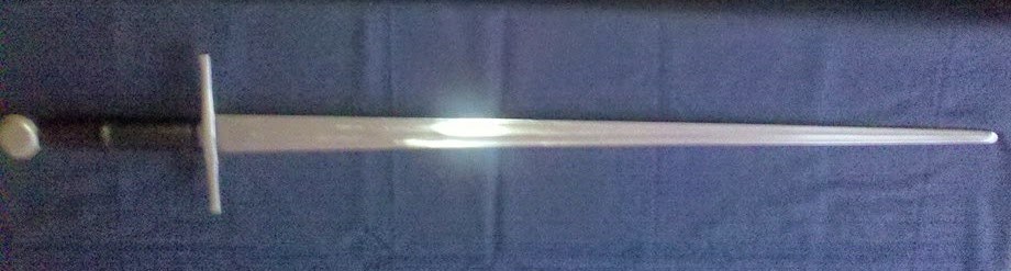

I've got my hanwei practical hand and a half sword
model 2014
Total length 111 cm
Blade length 87.5 cm
Center of balance about 12.5 cm
Handle 18 cm
Weight 1450 g
Tail of the tang is hammered in the pommel that you can see the hits from the hammer.
I thing maybe the pommel need to be little bit bigger. But this is my opinion.
I think for hand and half sword is not that heavy, but point of balance maybe need to be closer to the corss-guard.
Blade is little bit stiff, not that flexible. Which is not that save for sparing and reenacting, by historical view of point that is good, but still for long sword as this one, maybe will be bad...
First impressions, even the balance is so far from the cross guard, the sword is fast, and comfortable in the hand.
I will test him very soon. But still i hope to not get broke Happy
 Attachment: 51.97 KB

The pommel on iteration 5 is smaller than earlier versions. That may have let the COG go a little farther down the blade, but not excessively - it is still within 5 inches. Yes, it has a stiff blade. Many reenactors/bouters prefer a stiff blade without much flex - stage combat folks, not so much.
