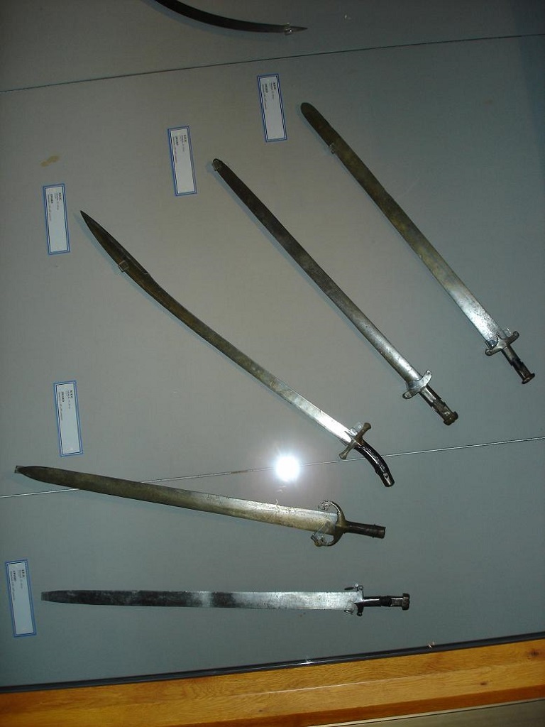

I do not have Rivkin's book in front of me this very moment, but I recall that one of the swords he shows there has a European blade on a Mameluke style hilt, but without the inscriptions found on the Alexandria arsenal swords, which typically state who gave the sword to the arsenal. Here is a picture of Mameluke "saif badawi" swords in the collection of the Askeri Museum in Istanbul, which show the typical Mameluke hilt of the 14-15 centuries. It is quite possible that not all of the swords taken from the Kingdom of Cyprus made it into the arsenal and some may have been hilted in Egypt. Then there is the question if by this time these were meant to be used in battle or were more of a ceremonial nature/status symbols, kind of like the jinettas of the Nasrids in Andalusia.
 Attachment: 136.56 KB
