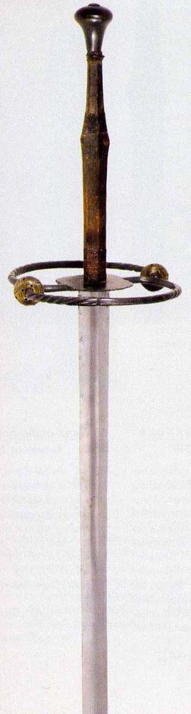

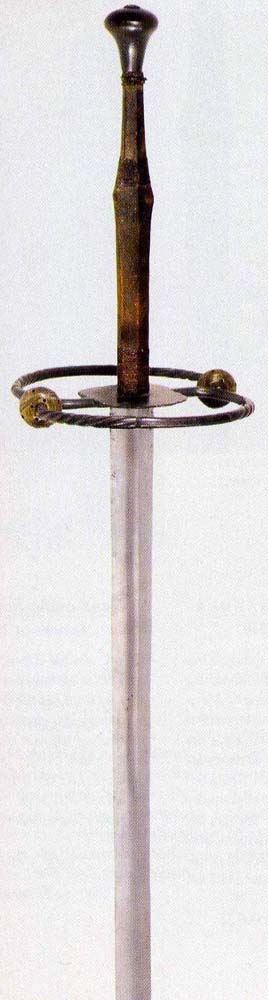

PostPosted: Wed 13 Apr, 2011 2:39 pm    Post subject:         Reply with quote
Should anyone have any information regarding this image, please share it here.
Thank you.
 Attachment: 122.8 KB
