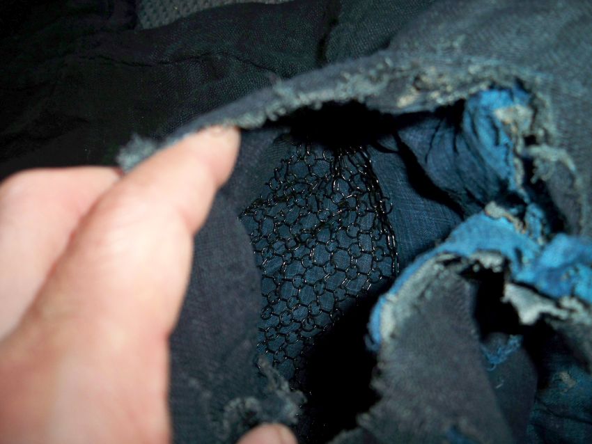

Ah I see. You meant kote as in the ones used in the practice of kendo. I should have remembered that you have used that example many times in discussions about textile armours.
AFAIK the Japanese lined all of their armours rather than wearing separate arming garments. Here is an image of a kusari katabira (japanese equivalent of a jaserant or kazaghand) sent to me by user worldantiques over on Armour Archive. Because of the hole, you can count the number of layers of cloth used in its construction. Apparently it has four layers on the outside and one on the inside. If you consider that this armour would have been worn over probably two undershirts, then that's three layers under, and four layers over the mail. This is a similar amount of layers that I suspect might have been worn with mail in 13th century Europe.
 Attachment: 91.19 KB
