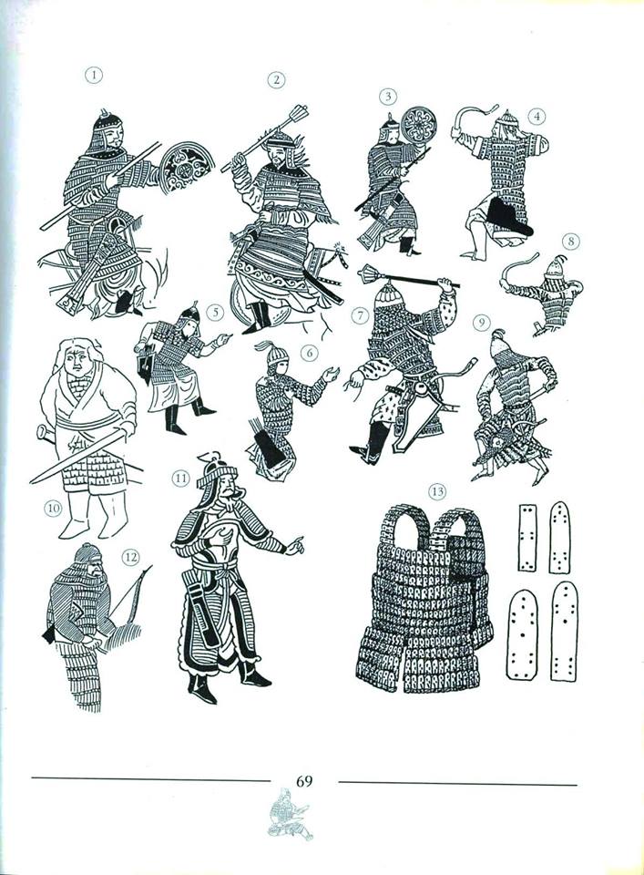

Hello guys
I am searching for sources for two handed maces being used by Eurasian Nomads in XIII-XV century..
I have seen some with long cavalry maces wielded in one hand with no shield in the other, but I would really appreciate it if anyone would share any source, where it is clear that the mace wielded is two handed..
Here is what I got already:
 Attachment: 101.59 KB

PostPosted: Tue 05 Nov, 2013 3:56 am    Post subject:         Reply with quote
Speculative drawings can't be used as evidence. You need physical examples. An extant mace head that weighs 2kg or more is likely to be from a two-hander (unless it is a ceremonial mace). Manouchehr's book has a Persian example that is 101cm in length and weighs 2910g.

PostPosted: Tue 05 Nov, 2013 7:24 am    Post subject:         Reply with quote
I know these drawings doesn't prove anything, that is why I came here in hope of someone else having knowledge about some known documentation. Most sources on the subject is in russian, and I can't read that..
Good tip on the weight of the mace head. I will try to look that book up.. Thank you.
