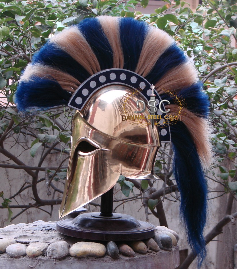

Recently I've been putting together ideas for creating an Hoplite kit, but would like to create one in the style of a Athenian nobleman. I'm familiar with the armor, but I am lost when it comes to the rest of the kit Worried
From what little research I can find, it seems the Athenians wore blue, rather then red, like the Spartans.I know Spartans were famed for wearing red cloaks, so that they would hide if they were to be bleeding.
So, what could I do to give the appearance of an Athenian nobleman? Below are a few images of what I have found that I like so far.
Also, if anyone knows of craftsman that work in bronze and could post some links, that would be awesome Cool I've spent a good deal online and I can't find a single craftsman that makes the armor or weapons.

I probably should have mentioned that I intend to train with this in the art of Pankration. So, it's needs to be historically correct for me and fit well. So the quality should be good.
I've looked through several venders and the only thing I saw that looked decent was Danyel Steel's corinthian helm (the one I posted above). The rest of the stuff I've found was off and was done in brass :/
I'd like to get it all done in Bronze if I could.
-Reece
