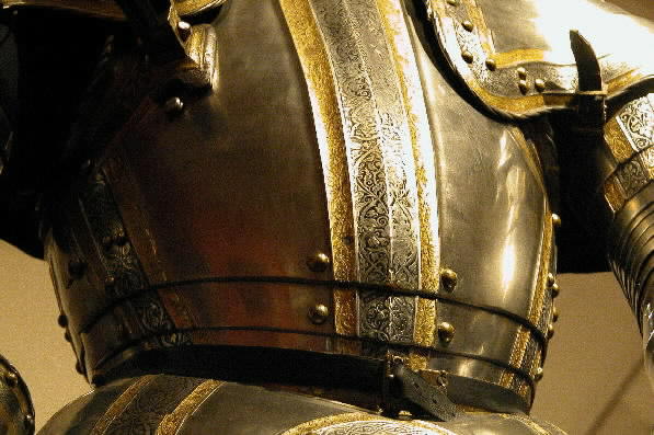

A peascod shape with one or more waist lames was not uncommon, especially in the Holy Roman Empire. They allow for a sleeker shape than the classic one piece, which requires that the lower it goes, the further it has to be from the body to allow forward bending.
 Attachment: 52.19 KB

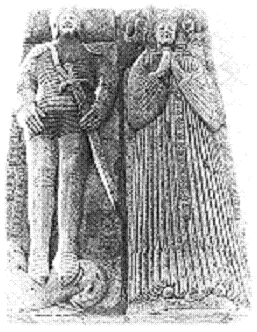

By the way, below is an image I found on-line of the effigy of Piers Butler, Earl of Ormond, and his wife. It does appear as if he wears an anime cuirass with fairly narrow lames. So maybe that particular reconstruction isn't too far off the mark. (Sorry for the poor quality, it was rather small, and I enlarged it.)
 Attachment: 33.7 KB
The tomb of Piers and Margaret Butler in Kilkenny.

Sorry for being rather vague, Ireland in the sixteenth century isn't really my main period of interest, but I'm always fascinated by the odd and different. I felt that the possible anime cuirass on the Anglo-Irish effigies was a bit different. I was wondering specifically about lords like Piers Butler, Earl of Ormond, and men-at-arms of the same ilk. I really don't know enough about the history of the time to place him as "New English", "Old English", or "Irish". The caption in the Osprey book stated that the armour was a bit archaic, especially on the man-at-arms in the same plate. I wonder if this means that they are "Old English". Would this mean that they would adopt a lighter style of armour as was possibly popular amongst the Irish? I'm always leery about relying on information in the Osprey books; I like to have other sources to back it up before I accept it as reliable. The photo of the effigy of Piers Butler that I found suggests that the colour plate wasn't too far off the mark, at least for that particular figure.

In the RA, William Herberts armour has two bottom lames on the breast plate from c. 1550ish. Perhaps helpful?
RPM

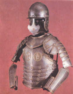

I found an image of a Hussar's armour from circa 1630. This example is an anime with a fairly large solid upper plate. It's an example of this form used into the 17th century in Eastern Europe. I know this is straying off-topic a bit, but I thought I would share what I found.
Stay safe!
 Attachment: 9.95 KB
Hussar armour, 1630.
